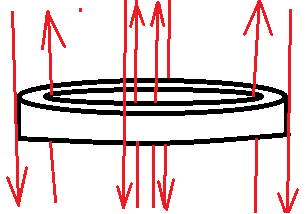

Did you have rough picture on hand, or a link to a picture, I'm having trouble visualising what you said, when you said it 'cancels out with the wires on the oposite side', do you mean like if you drew a line from a wire on one side, through the centre to the other side of the toroid, that wire's B field would cancel out? Because that makes sense, INSIDE the toroid, as the oposite fields are facing each other, but what about the outside of the toroid where they're facing away from each other, or the top, where they're not facing each other? I'v attached a small picture example of these fields.
I don't have a picture, but that is the idea, yes. Inside, contributions from all cables add, outside, they cancel partially.
You mean inside the core I assume, but I mean inside the central donut hole I can see them canceling (two blue circles of opposite direction interacting) but on the outside of the toroid you can see that the blue lines propagate in opposite directions, so how can they cancel?

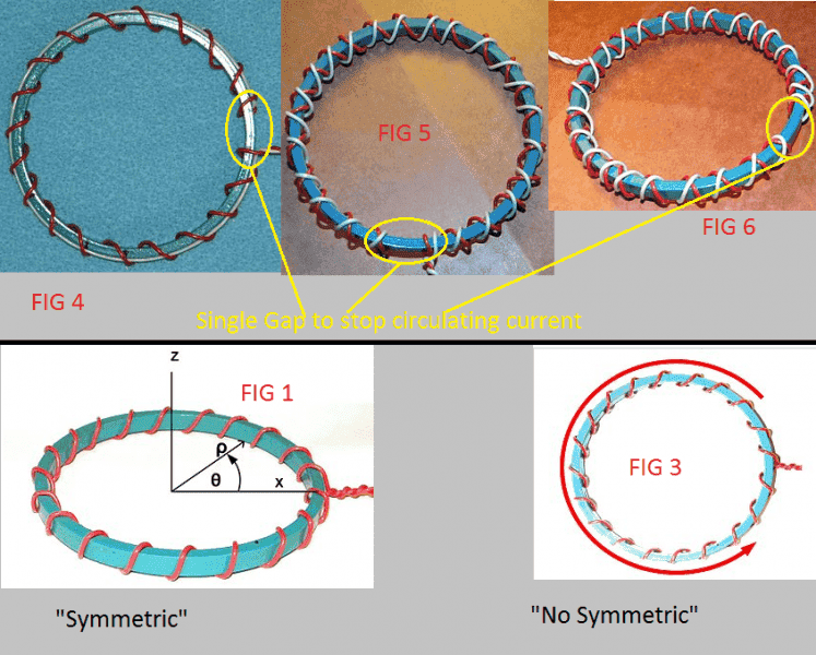

According to Wiki: "Fig. 3. Toroidal inductor with circumferential current Figure 3 of this section shows the most common toroidal winding. It fails both requirements for total B field confinement. Looking out from the axis, sometimes the winding is on the inside of the core and sometimes it is on the outside of the core. It is not axially symmetric in the near region. However, at points a distance of several times the winding spacing, the toroid does look symmetric.[4] There is still the problem of the circumferential current. No matter how many times the winding encircles the core and no matter how thin the wire, this toroidal inductor will still include a one coil loop in the plane of the toroid..."
http://upload.wikimedia.org/wikiped...uctor-Simple_with_Circumferential_current.JPG
From:
http://en.wikipedia.org/wiki/Toroidal_inductors_and_transformers
But the picture (Fig 3.) looks just as symmetrical to me as Fig 1. on the wiki page so what's causing the lack of symmetry?

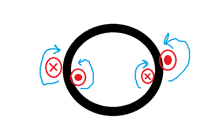

tim9000 said:
Is this picture what you were talking about:
No, your current shown in red should always travel in the same direction through the hole in the toroid.

In fig. 3. The circumferential current is because the helix of wire wound on the toroid has a component that follows the surface of the toroid.

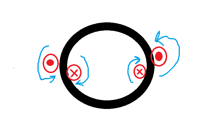

Ok so it needs to look like this:
When Wikipedia says:
"Figure 3 of this section shows the most common toroidal winding. It fails both requirements for total B field confinement. Looking out from the axis, sometimes the winding is on the inside of the core and sometimes it is on the outside of the core. It is not axially symmetric in the near region. However, at points a distance of several times the winding spacing, the toroid does look symmetric"
As far as I count there are an even number of windings, and if you cut the toroid in half it is a mirror of the other side. So do they mean that the exact distance of spacing between each winding isn't completely uniform or something, and THAT is where the lack of symmetry is coming in?
Yes, the wire always carries the current through the toroid hole in the same direction.

No. For a simple helical coil there will always be one toroid of circumferential wire. By winding the coil back over itself, or threading the tail(s) back around the toroid to a common starting point, the circumferential current can be canceled exactly.
See fig 4, and fig 5, http://en.wikipedia.org/wiki/Toroid...for_total_internal_confinement_of_the_B_field

Re: http://en.wikipedia.org/wiki/Toroidal_inductors_and_transformers
Figures 4, 5 and 6 all have a single gap in the winding along the toroid that is not passed by any wire.
The turns are still symmetrically spaced over the core.
It may be counter-intuitive, but that gap means the winding cannot have a circumferential current, hence it has better balance.
Oh, Oh I think I see the gap you're talking about:

You could have the return wire running back along on the outside of the winding, rather than on the inside (as in Figure 4) ? Couldn't you? Just as long as it was carrying current in the opposite direction in the toroidal plane?
Maybe I was misunderstanding, the picture on the bottom left labled (Figure 1) "symmetric" is that actually symmetric? Maybe I just thought it was, because the picture on the bottom right (Figure 3) is: "Looking out from the axis, sometimes the winding is on the inside of the core and sometimes it is on the outside of the core. It is not axially symmetric in the near region." And as I said, I can't see a difference between the two, they both look symmetric to me.
Thanks again! This is really helping me
The term symmetry has too many interpretations to be useful. Fig.1, and Fig. 3, are topologically identical.
Yes, you have found the gap.
Current cannot flow across that gap, so there can be no net circumferential electric current.

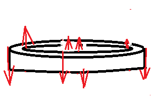

If a setup in this way:
comprised of current flowing through infinitely long wires, around a toroidal core, existed, would it meet the criteria for total confinement?
No, it would not be confined to the toroid. That is because there are many "toroids made of space" above and below your magnetic toroid. Each of those would have a circular magnetic field passing between the four inner and the four outer wires. The magnetic toroid could only gather a small amount of the field from nearby along the wire. The rest of the field would be through the air so it would not be confined.
Magnetic fields prefer paths through magnetic materials when such paths are available nearby. But when a much shorter loop through space is available, a field is not going to travel a long way through space and back just to pass through a magnetic particle.
You need to pull the wires tight against the toroid to eliminate the air-gap in order to achieve total confinement.

Inductance rises as the area of the loops increase, so would you not expect total confinement to reduce the inductance to a minimum? Less confinement, more inductance?
I hadn't been thinking about loop area being really a factor as long as the loop is flush against the core. For instance, as long as the core is large the loop size can be large and the inductance can be high. So I'm not really following your line of reasoning, besides limiting EM interference, if it was so detramental to inductance I'm not sure why anyone would seek total internal confinement.
To answer your question, I'm trying to imagine two cores of the same size and same loop size, one with a return winding, one without, and I'm honestly not sure whether the energy stored in the core or energy in core + energy in the air is better for induction. I'd have thought just energy in core (internally confined) but that seems to be contrary to what you're implying with your question.
Winding tight against the toroid reduces external coupling. It also reduces the length of wire needed to get the inductance required. A shorter wire length has less resistance, so the Q of the inductor is higher.
Adding a return winding very slightly reduces the inductance because the one circumferential current loop with an air core is cancelled, it slightly increases the resistance but greatly reduces the external coupling.

There are two ways to wind a coil onto a toroid. A turn can pass through the hole or it can run externally along the toroid without entering the hole. Those are two quite different magnetic situations.
A winding that passes through the hole has a closed path for the magnetic field that remains within the magnetic material of the toroid, with high inductance. An external winding has half it's magnetic field through air and so has much lower inductance per turn.
You cannot equate those two quite different perpendicular paths to combine them into the one inductance equation.
The number of turns on a toroidal core is a directional count of the number of times the same wire passes through the hole.
  • #33
Agreed and understood, I'm just not sure why if it was totally confined then why would:
" as I said, I'd have thought better confinement in the core, more inductance.
Ok, say that N is the amount of loops the wire does around the core, through the hole, so a return path does nothing to that inductance equation?
  • #34
The one turn circumferential loop that can be canceled by a return winding is perpendicular to the wanted toroidal current and field, so the total inductance is the simple sum of those two inductances in series. When you introduce a return winding, you cancel the smaller external inductance and so only the toroidal inductor remains.
That is why a return loop compensated toroidal winding will have a significantly lower external field, but at the cost of a slightly lower total inductance.
