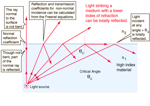

I believe the example you are looking at is demonstrating "partial internal reflections" not "total internal reflections".
See the diagram below (from.. http://hyperphysics.phy-astr.gsu.edu/hbase/phyopt/totint.html).
On the left the angle of incidence is such that the light is partly relected and partly refracted.
As the angle changes there is a point at which the light that emerges is refracted along the surface. This is called the critical angle.
On the right the angle is such that the light is totaly reflected and no light emerges.

Because the very last reflection is partial there will be a faint emerging ray which is the one you describe as leaving the mirror.
In the real world you would probably get a lot more internal reflections because mirrors have parallel surfaces. That means once the ray is bouncing around between the surfaces the angle of incidence doesn't change much so there is nothing but the edge of the mirror to stop internal reflections. That's more or less how crude fiber optic cables work.
My thanks to CWatters :)
So this is an example of partial internal reflection isn't it??
I was confused because the heading was written as total internal reflection..zz
It's been a great help xD Thank you!
