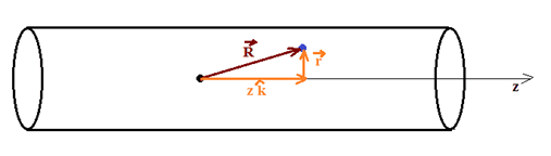

Here, I think you have notational confusion. Angular momentum is calculated relative to the origin. You can let ##\mathbf{R}## be the position vector of a point relative to the origin. So, angular momentum density would be ##\mathbf{l}=\mathbf{R}\times\mathbf{g}##. Be sure to distinguish between ##\mathbf{R}## and ##\mathbf{r}##. You can write ##\mathbf{R}## in terms of ##\mathbf{r}##, ##\hat{k}##, and ##z##.

I used cylindrical coordinates as we have an infinite solenoid. I think angular momentum is relative to Z axis and so ##\mathbf{R}=\mathbf{r}##. I followed example 8.4 in Griffiths Introduction to Electrodynamics 4º Ed. He calls "s" "horizontal" distance from a point to Z axis and he makes a product independent of s. I don't know if these is correct for this problem.
Looks like maybe Griffiths is using ##s## for your ##r##. For example, you wrote the electric field in terms of ##r## which implies that you are using ##r## for the perpendicular distance from the axis. But, when calculating the angular momentum density ##\mathbf{l}##, you need to use the vector from the origin to the point where you are calculating ##\mathbf{l}##. So, you need a different symbol for this vector, say ##\mathbf{R}##. For a general point inside the solenoid, you should find that ##\mathbf{l}## has both an ##\hat{r}## component as well as a ##\hat{z}## component.

OK. I think finally I've understood it with your drawing.
I make ##\mathbf{R}=\mathbf{r}+\mathbf{z}=r\cos\phi\mathbf{\hat{x}}+r\sin\phi\mathbf{\hat{y}}+z\mathbf{\hat{z}}##.
Making ##C=\frac{-\mu_0nI\lambda}{2\pi}##, I find ##\mathbf{g}=\frac{-C}{r}\sin\phi\mathbf{\hat{x}}+\frac{C}{r}\cos\phi\mathbf{\hat{y}}##. And now ##\mathbf{l}=\mathbf{R}\times\mathbf{g}=-\frac{Cz}{r}\cos\phi\mathbf{\hat{x}}-\frac{Cz}{r}\sin\phi\mathbf{\hat{y}}+C\mathbf{\hat{z}}##.
We compute total angular momentum per unit length
$$\mathbf{L}=\int_0^1dz\int_0^ardr\int_0^{2\pi}\left(-\frac{Cz}{r}\cos\phi\mathbf{\hat{x}}-\frac{Cz}{r}\sin\phi\mathbf{\hat{y}}+C\mathbf{\hat{z}}\right)d\phi.$$ But, ##\int_0^{2\pi}\cos\phi\, d\phi=0##, and ##\int_0^{2\pi}\sin\phi \,d\phi=0##.
Finally we get:
$$\mathbf{L}=C\pi a^2\mathbf{\hat{z}}=-\frac{\mu_0 nI\lambda a^2}{2}\mathbf{\hat{z}}.$$
Thanks a lot for your help!:smile::smile::smile:
Yes, that looks very good.
You can shorten the work a little by using symmetry. It should be clear that the total angular momentum ##\mathbf{L}## only has a ##z## component. So, you only need the ##z## component of the angular momentum density ##\mathbf{l}##, which is what you actually calculated in your first post. So, you got the correct total angular momentum in your first post.
