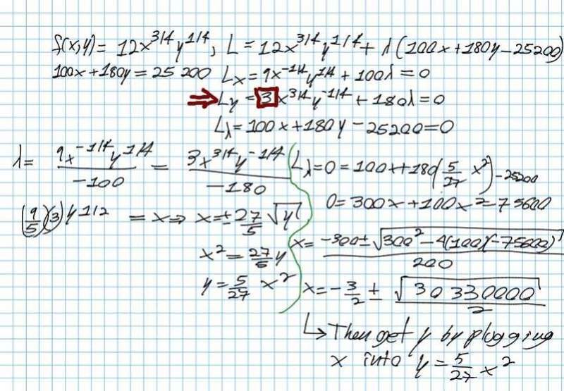

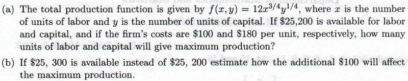

Attached as Question.jpg.
Partial differentiation.
Lagrange multiplier equation.
Attached as MyWork.jpg.
Is my work correct? I'm still not confident with myself for these problems and it would be great if someone could confirm if I did this problem correctly and also, the values (or value since I can ignore the negative because it makes no sense in the problem) I get seem rather strange and, knowing my teacher, he usually gives problems with numbers that work out well and his notes also have nicely fitting numbers.
You made a blunder: you started with
[tex] L = 12 x^{3/4}\, y^{1/4} + \lambda (100 x + 180 y - 25200) [/tex] and wrote
[tex] \partial L/\partial y = 12 x^{3/4}\, y^{-1/4} + 180 \lambda, [/tex]
which is incorrect.
RGV
Actually, I don't think so. (If that sounds rude, I don't intend to.)
Looking back at my work here, I see a coefficient of 3 and not 12 for L_y.
Could you tell me if I am right or wrong about this please?

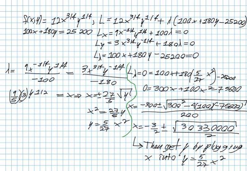

I marked it in red to show what I am talking about in case we're mis-communicating. (It seems to be the third line too.)
I was not referring to the "3"; I was referring to the [itex] y^{-1/4}.[/itex]
RGV
Yes, you have "3" correctly. However, your power of y is wrong. 1/4- 1 is not equal to -1/4.

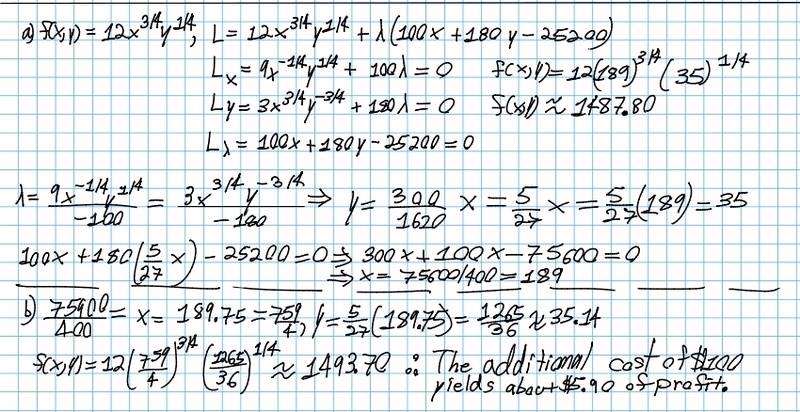

Oh, yeah, oops. :shy:
Is the current attached work correct?
