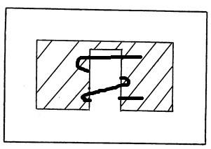

I am looking for a general explanation of when the total reluctance of a magnetic circuit is not equivalent to the sum of the reluctances if each area. In several examples the text has added 2 areas in parallel and then added the third area. I'm not 100% sure on when this is required.
I use R=l/(μA) to determine the reluctance of each area, but don't know if/when reluctances need to be added in parallel.
For example, if I have a shape like this:
where the shaded region is air and the rest (the white area) is iron, I calculated the reluctance for the left, middle, right and small air gap. However, is the total the simple addition of them or are the left and right "legs" in parallel?
The center is in series with the two outer loops which are in parallel.
See page 11 of 35 in http://www.ece.msstate.edu/~donohoe/ece3183magnetic_circuits_and_transformers.pdf
or page 29 of 33 in http://www1.mmu.edu.my/~wslim/lecture_notes/Chapter4.pdf
It's a fairly standard magnetic circuit. One must treat the air gap as well.
Thank you very much. Those two documents were perfect explanations for this particular circuit, but I'll read them further so I gain a better grasp of the general principles as well.
