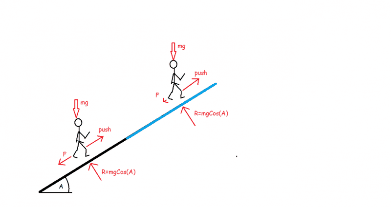

Incidentally, in your equation W=Fdx+mgh if Fdx is the work required to travel horizintally for a distance dx, then I would say it should be W=Fds+mgh where ds is the distance traveled along the route chosen.
Even if you climbed a ladder, you would have Fds for the height of the ladder, ds = h, and F = (the vertical force applied) - mg . The vertical force here must be greater than mg since you have to lift your leg on each step. Generally F is part of the "sports" aspect involved in bodily reconfiguration and applies throughout the distance actually traveled and of course also changes in magnitude depending on the direction of travel.
Because I want to avoid this F coming from the body and that it's difficult to define i just assumed a body (dimensionless for simplicity) that needs a known value force to move up an inclined floor with no friction. so this F should be greater in magnitude than the projection of weight on x-axis which should be B(x)=mg sin(θ) where θ is the degree of the inclination.
And then the work would be W=F dx where dx now is the hypotinuse.
So F=mg sin(θ) where sin(θ)=200/3006, where 3006m is the hypotinuse so sin(θ)=0.07
F=600*0.07=42 N
so the work would be W=Fdx=42 * 3006 = 126252 J ≅ 30.15 kcal
(use this site for conversion:
https://www.unitjuggler.com/convert-energy-from-J-to-kcal.html?val=126252 )
This result is again without friction but with friction it would be F=mg sin(θ) + μNcos(θ), where μ is the friction coefficient and N is the reaction to the surface due to the weight.And then the work would be W=F dx⇔W=mg sin(θ) dx+ μNcos(θ)dx.
With this approach we do not need the unknown F from the horizontal motion.
Assuming a human body with all metabolism and muscles working this F that I found would be multiplied with a human-body chemical-to-usable kinetic energy conversion coefficient (with obvious max value 1 for 100% efficiency) that would tell us the efficiency of human body energy conversion so we can calculate the total calories needed to move up the hill.
Taking data from:
http://web.applied.com/assets/attachments/492ACC9E-E5C2-2D43-0B8CCDA72ACE3361.pdf
for Rubber tire on pavement which would be our shoe of course the friction coefficient is around 0.85
sooooo W=mg sin(θ) dx+ μNcos(θ)dx⇔W=126252(from previously) + 0.85*600*(3000/3006)⇔ W=126252+509⇔W=126761 J≅30.27 kcal.
Now according to Wikipedia the energy conversion efficiency for the muscles is 14–27%.
So If I say that it is about 20% that means that this 126761 J is the 0.2 so the total work that the body needed in the first place was W=126761/0.2=633805 J≅151 kcal, which sounds right.
idk anymore I've been thinking over this matter for days now, I even had a dream about it :P
If the friction force on BF is down hill, what is pushing him uphill?
If I stand still on a slope, gravity is pulling me down the hill, but what is balancing that?
If I stand on an icy slope so that there is very little friction, which way do I slide? Then when I slide off the ice onto a rough part, which way is the friction force on me?
I don't know the answers, I just ask what is on my mind. I'm always puzzled when an object pushes itself along, but friction is supposed to oppose its motion. Cars obviously do work against friction as they need petrol even moving on the flat, but if you remove friction by putting oil or ice on the road, they don't move. The ultimate example seems to be a baby sitting on the floor pushing itself backwards: friction is clearly pushing against the movement, as you can see its trousers or nappy being pushed down, but nevertheless it moves.)
the force that he creates with his muscles pulls him up.
what balance you is a force also coming from your body that is the same magnitude with your weight so that ΣF=0.
with the friction pointing downwards i guess you would start to accelerate downwards unless you oppose it with a force from your body. even if you change terrain friction will continue to face to the opposite direction from the one you are heading.

I'm not sure how his muscles pull him up, or how forces come from your body. I can see how you apply forces to other objects, but not how you apply a net force to yourself.
Have you come across Newton's third law?
Anyhow, if I understand your answers, I should be able to run up an icy hill much easier than up a rough hill:

yes if you take the inclination into account. that's what I did above :)
  • #31
the third law says about action and reaction but of course these two are applied to different bodies. like i create and push the ground and the ground pushes back.
also in a theoretical model yes, because in reality you would slide down and the go back and try again so the effort would be much more. on ice there is less friction but then you have the slippery aspect :P and as we know we walk and move around thanks to friction, that's why you can't move up an ice hill because the friction is minimum
  • #32
And I think, the ground pushing back is the forces of friction and normal reaction. You pushing down on the ground is opposed by the ground pushing up on you, and you pushing backwards on the ground is opposed by friction pushing forwards on you. Which is where I start to get concerned about the work we do against friction when walking.
Anyhow, this is getting a bit away from ur original Q. My point was simply that the work done going horizontally was not work against ground friction, but work lifting legs and feet over the ground.
