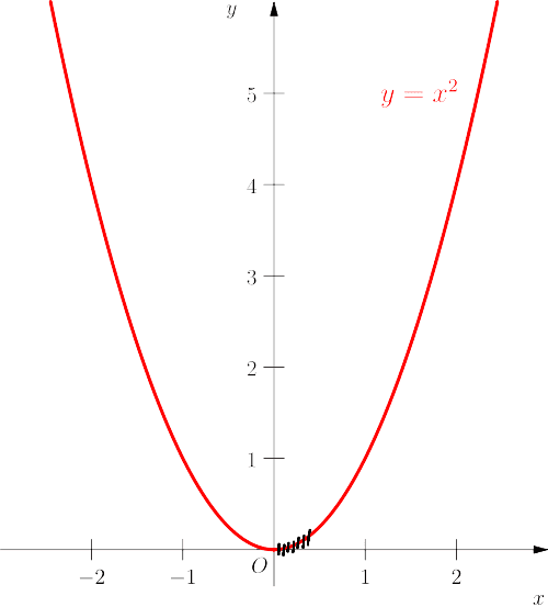

Putting it an entirely different/simpler way:
On the pic of the graph attached (y=x2), there are 7 equidistant points marked. The sum of all the points = 1.
What are the values for the individual points?
What is the formula used to find the values of these points?
Thanks again, sorry if muddled. :redface:

So you do not want "exponential" behavior. You want "quadratic" behavior instead?
For exponential behavior, each contestant's payout would be a fixed ratio greater than the next lower contestant's payout.
For quadratic behavior, each contestant's payout would be a linearly-increasing amount greater than the next lower contestant's payout.
1, 4, 9, 16, 25, 36 = quadratic
1, 2, 4, 8, 16, 32 = exponential (also known as a geometric series).

The problem reduces to finding a "quadratic" payout graph for the n people in the top 20% of the field.
That, in turn, reduces to taking the sum of the squares of the first n integers.
The sum of the squares of the first n integers is n (n+1) (2n+1) / 6. Call this "sum"
The fraction of the total payout for the lowest ranking person is 1/sum.
The fraction of the total payout for the next lowest ranking person is 4/sum.
The fraction of the total payout for the next lowest is 9/sum.
The fraction of the total payout for the highest ranking person is n2/sum
You can see that the fractions add to 1.
