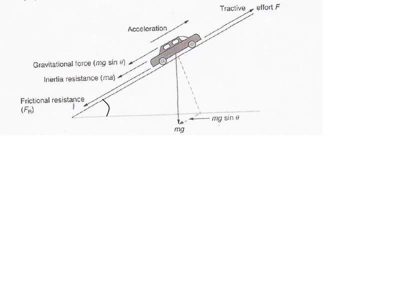

I have been working on this problem now for a good few weeks and I think I am nearly there just need help on the last bit.
The Question:
A car of mass 1200kg accelertaes from 2.5 to 5.0 ms while traveling up a slope of 1in 10, through a distance of 60m. If resistance to motion is 105N determine using both an energy method and D'Alemberts principle
a) The tractive effort F required
b) Work done
c) average power required to accelerate load
What I have done so far.
Part a)
I worked out acceleration using a=(v^2 - u^2 ) / 2s giving me a= 0.15625 m/s
Then using m x a to work out inertia resistance = 187.5N
I then worked out the angle ( bottom left of traingle ) by using slope of 1 in 10 = 0.1 and doing tan-1(0.1 to give 5.71 degress
I then worked out the gravitational force m x g x sin pheta ( 1200 x 9.81 x sin(5.71 )
This gave 1171.357N
Adding these with my original resistance to motion gave me a tractive effort of 1463.857139N
Part a) done hopefully
Part b)
Work done = f x s
1463.857139 x 60 = 87831.42834 Nm
Part c) Power = work done / time taken
Time taken = change in velocity / acceleration
2.5/0.15625 = 16 secs
Power = 87831.42834 / 16 = 5489.4642
I divided this my distance of 60m to give 91.49107 Nms
This is where I am stuck I understand I need to use conservations of energy which mean working out PE and KE.
Intial KE
KE= 1/2 m x v^2
600 x 2.5^2 = 3750J
Final KE
600 x 5^2 = 15000
Give me a change in KE of 11250
And that as much as I can do.
Sorry for it being quite long but I really want to get through this question. Any input is greatly appreciated. Thanks
I will attached a picture of a diagram that also comes with the questions
Thanks again

badsanta010, welcome to PF! You've done some good work thusfar using Newton's laws, but with a clarification required and an error, see below. (Note: You should probably round off your answers to 2 significant figures)

This looks good so far, very good

Nm is usually referred to as Joules, but this is where clarification is needed. This is the work sone by the tractive force, which I assume the problem is asking for? Most all the forces (tractive force, gravity, resistive forces) do work, so the problem should be more specific when it asks for "work" done.

yes, this is the average power delivered by the car, units should be Joules/s, or Watts
why? You already calculated the average power above. Go no further.

Using energy methods, your change in KE is correct. What's the change in PE? Then use the conservation of energy equation which states that the change in KE plus the change in PE must equal the work done by the non-conservative (tractive and resistive) forces.

Total (or net) work done by ALL forces is change in KE, that's why I asked for clarification...I woudn't use this equation
I did'nt know change in PE could also be added to this
For some clarification (or possible confusion), note that W_net = change in KE, and W_nc = change in KE plus change in PE , where W_net is the work done by all forces, including gravity, and W_nc is the work done by non-conservative forces (that excludes gravity).
