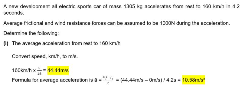

A car weighs 1305kgs and accelerates from 0 to 160km/h in 4.2s. The first question asked what the average acceleration would be. I converted the terminal speed to m/s which came out at 44.44m/s.
Then I did a calculation for the average acceleration as shown
ā = (44.44m/s – 0m/s) / 4.2s = 10.58m/s²
Is this correct?

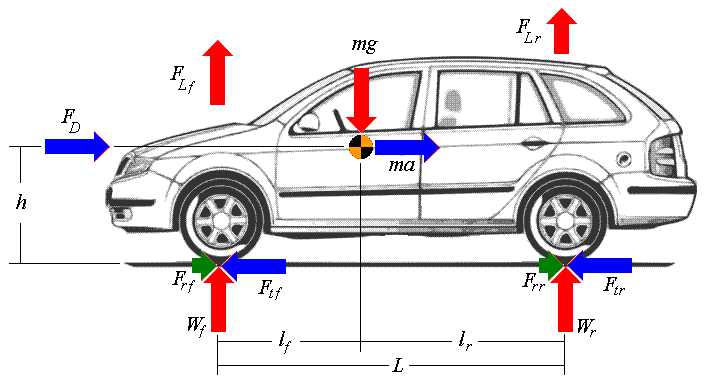

To find the answer, do a free body diagram (FBD). You have the tractive force, the wind resistance, and the inertia (ma). All of these are vectors. Direction matters. Do the FBD, write the equations, and show them to us in your next post.

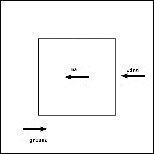

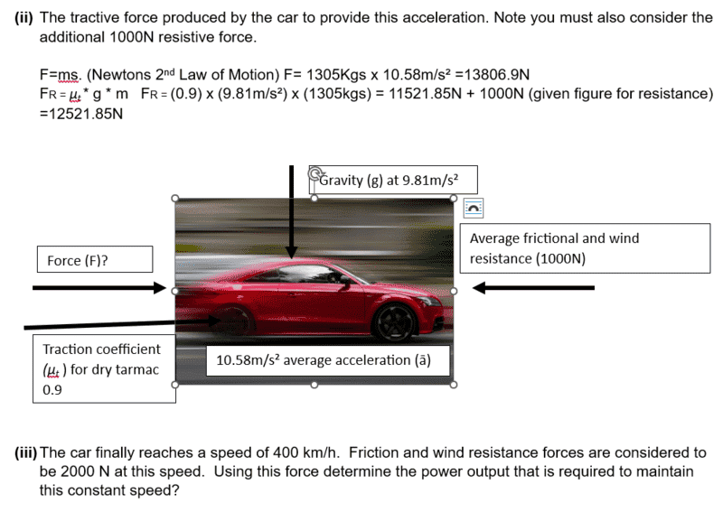

This is what I have so far. I've looked at other posts along a similar line and followed their examples with regards FR. Is any of this correct or am I missing something? The posts I saw had the 2 answers added together F + FR to give the force required to travel the object at a constant acceleration. The question I've been asked is what is the tractive force produced to provide this acceleration taking into account the 1000N resistance. Same answer?
Or do I subtract the 2 answers F - FR = 1285.05N as the answer? This, to me, makes more sense as surely the resistance is the force the car needs to overcome to maintain acceleration and then hold a constant speed?

The friction coefficient ##\mu## is not given in the problem so forget about it. The force ##F## is what you are looking for. You have put the wind resistance vector on your FBD but not the inertia vector (ma). Add those three vectors (considering their correct directions) to find the magnitude of ##F##.

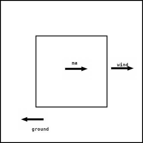

This is right but you don't seem sure.
If you had done the FBD as I asked, it should be clear. In the figure you presented in post #16 you show the force ##F## pointing to the right and the wind resistance pointing to the left. This is good. The ##ma## vector should be opposing the ##a## vector. In your case, it will point to the left. Intuitively, you should be able to figure out that a car that is accelerating (acceleration pointing to the right) requires an effort from your engine. Thus the ##ma## vector is pointing to the left. So you get:
$$F = F_{wind} + ma$$
Do you see how your tractive force ##F## is opposing both the wind and the inertia of your vehicle? The greater the wind or the greater the acceleration, the greater the required tractive force. Does it make sense?
The net horizontal force is what produces the horizontal acceleration that you have calculated.
That net force is the summation of all the horizontal forces acting on the chassis of our car.
The shaft of each tire-motor assembly pushes the chassis forward as the contact patch acts as an instantaneous grounded pivot.
The 1000 N force simultaneously pushes the chassis rearward.
Therefore:
Net force = car mass x acceleration = F shaft - 1000 N
Car mass x acceleration + 1000 N = F shaft

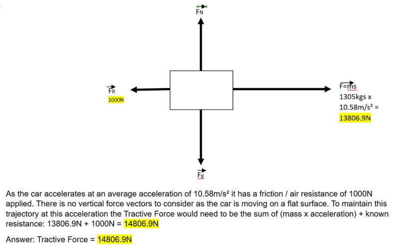

Gixer1127 said:
Folks, is this any closer to the correct answer?
The FBD is wrong. The tractive force ##F## is not on it and the inertia vector is in the wrong direction.
Can't you see that 13806.9 N is not equal to 1000 N? Use this one as an inspiration (source):

Damn, back to the drawing board.

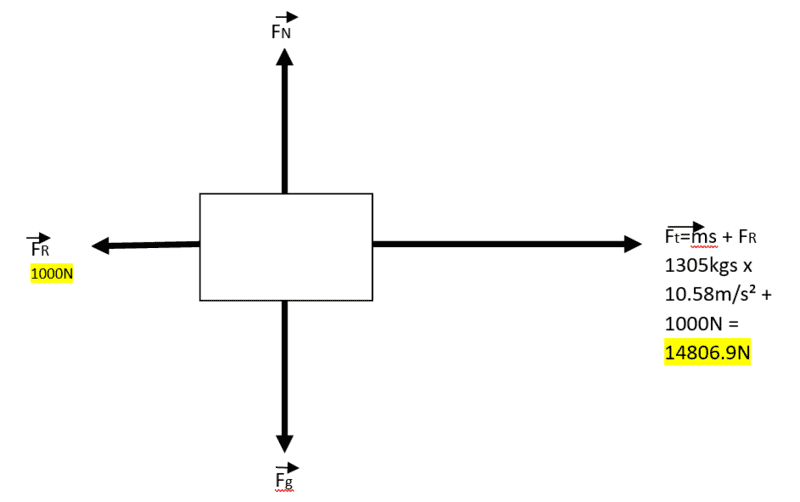

So the mass x acceleration is pointing the wrong way? I've got the car driving left to right so I thought that would have been the direction of inertia. I'm really struggling here but will persevere and get the right answer...eventually.
OK, so is my answer of 14806.9N correct for the tractive force? I've been over all the posts and this is the only answer (so far) that I can come up with. If this is correct then I'll submit the wording only on how I accomplished this with a nod to Newtons 2nd Law of Motion. I do want to know where I've gone wrong with the FBD though and have seen an FBD with inertia (ma) pointing backwards. I'll have a look at this to try and figure out the why's and how's of this.

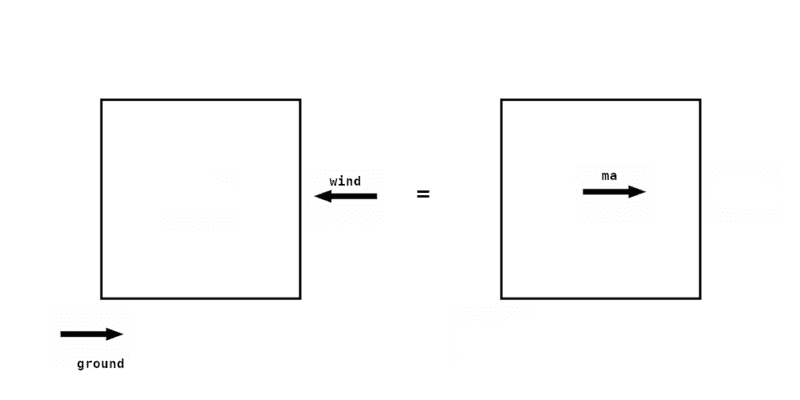

Yes, 14806.9 N is right.
For the FBD, there are two ways to look at it.
The way I explained it: What is pushing onto the car?
  • The ground is pushing the car with the tractive force
  • The wind is pushing the car in the other direction
  • The inertia is "pushing" the car backward (because the car doesn't want to slow down unless compelled to)
The opposite way: What is the car pushing against?
  • The car pushes against the ground
  • The car pushes against the wind
  • The car's inertia "pushes" it forward
Both analyses will have equal and opposite arrows but will lead to the same conclusions because of Newton's third law: To every action, there is always an opposed and equal reaction.
A third way of looking at way might be this way: A diagram on each side of the equal sign of ##\sum F = ma##. (The second one is actually called a kinetic diagram) This way, all arrow directions might be more intuitive.

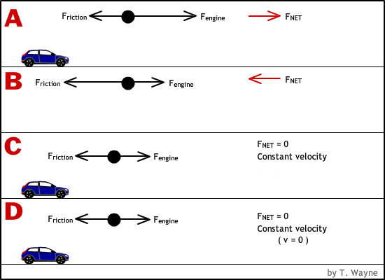

  • #31
I think it was Sir Isaac Newton that stated something like this:
"A body at rest tends to stay at rest."
"A body in motion tends to stay in motion."
Since the body you are talking about is a car that is trying to accelerate, its tendency (inertia) is tending to keep it at rest.
I know, we usually use the word "inertia" in the case of something that is moving tends to keep moving; but it works both ways!
So for a FBD, the arrow for Inertia points toward where the object (car) would be if no force were applied to it.
Hope this helps!
Cheers,
Tom
Likes Gixer1127 and Lnewqban

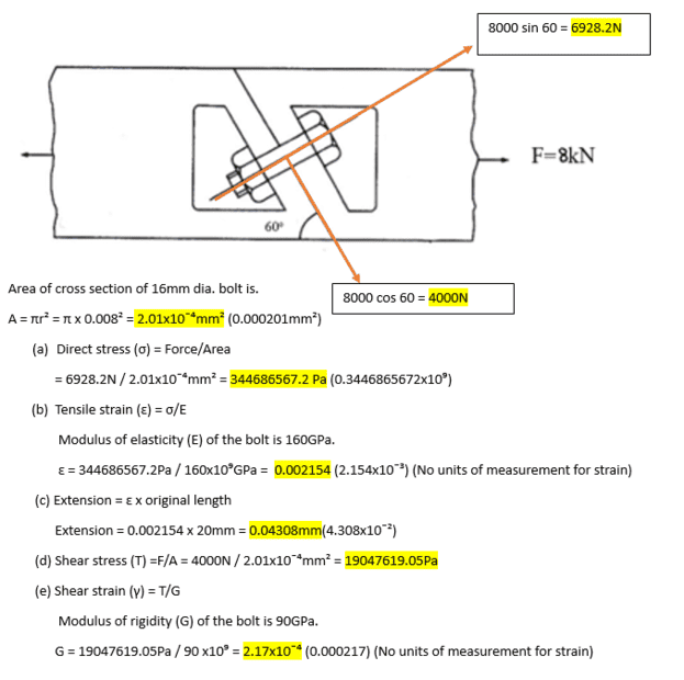

Hey folks. I've just had this come back as wrong from my tutor. He's saying the decimal point in (a) is in the wrong place. This in turn leads onto an incorrect answer for (b) and (c) Any pointers on where I've gone wrong?

It's OK, I've seen the error of my ways
  • #35
Gixer1127 said:
... Hey folks. I've just had this come back as wrong from my tutor. He's saying the decimal point in (a) is in the wrong place. This in turn leads onto an incorrect answer for (b) and (c) Any pointers on where I've gone wrong?
In your calculations, avoid using mm for length, area or volume.
Before you start plugging numbers into equations, transfer all given data to the International System of Units:
https://en.wikipedia.org/wiki/International_System_of_Units
In your case, make those 16 mm of diameter 16/1000 meters first.
One good clue about your error in a) answer was the result of a fraction of 1 mm2 as the cross-section area of a circle of 16 mm diameter: impossible.
Another clue on b) and d) answers: Pascals are N/m2 rather than N/mm2.
