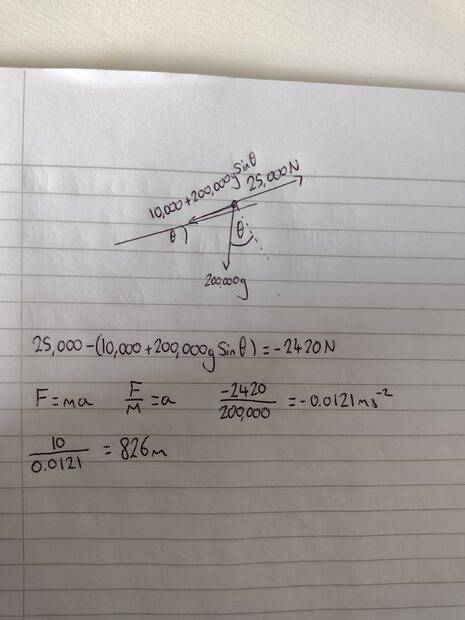

Hi I've been trying this question but keep getting the wrong answer any help would be appreciated 🙂
F=ma
Would you mind writing down the units (all of them) and see whether they check OK?
Likes FactChecker
Lnewqban said:
I can see two errors:
* Revise your math regarding resultant net force.
* Incorrect equation for calculating distance.
Please, see:
http://hyperphysics.phy-astr.gsu.edu/hbase/mot.html#motcon
Thanks for that mate just redid it and got the right answer will definitely be more thorough with my calculations next time!😂
Likes Lnewqban
