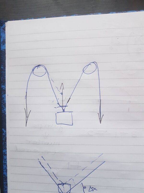

Hello everyone, this is a thought experiment I made, it involves two ropes being pulled of a pulley similar to an atwood machine, and a block attached to the two pulleys at the other end. The ropes are being pulled at a constant velocity $ U$ from the end away from the block and the block rises up in the middle. Now, I know the velocity of block,
$$v = \frac{u}{ \cos \theta} $$
but, how would I use this to derive the equation of motion of a mass segment on the string? (supposing the string has mass)
This expression seems quite hard to integrate because ## \theta ## is a function of time, (another difficulty)
Any help would be appreciated :)

Doesn't really mattter, because you impose speed ##u##.
That is the speed for the rope once over the pulley, so I suppose you are interested in the section that stays between the pulleys ...

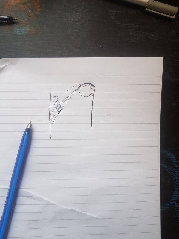

You want to make a better sketch (rope segments move away from the symmetry axis, not towards it) and claerly define a few things (##\theta##, for example)
By the way, 'equation of motion' is something else than a trajectory description...
@BvU Yes I'm interested in any small mass segment belong to the large mass segment hanging over the pulley, the ## \theta ## that I refer to is the angle which the string is inclined from the vertical line passing through the block

You are making it too difficult for yourself. There is no freeze framing. Suspension point ##P## is moving straight up towards ##M##.
Length ##PM## is known as a function of time$$PM = \sqrt{(L_0-ut)^2 - (D/2)^2}$$
Angle ##\theta## is known as a function of time too $$\theta = \arcsin \left (L_0-ut\over D/2\right )$$
The segment that doesn't go over the pulley undergoes a motion that is the sum of the upward motion and the tilting: red, purple, blue in the sketch
The motion of a point on that segment at distance ##r## from ##P## is then easily described as the sum of the motion of ##P## plus ##(r\sin\theta, r\cos\theta)## in a cartesian coordinate system with origin ##M##:$$(x,y) = \Bigl (r\sin\theta,\; r\cos\theta- \sqrt{(L_0-ut)^2 - (D/2)^2\;}\ \Bigr )$$
There is no reason to expect a simpler expresssion

OH I get it now, it clicked from when you wrote it in terms of arcsin. Thank you for bearing with me.
