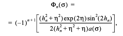

i have a transcendental equation and i have not a mathematique superieur formation ( I'm an hydraulic engeneer) and i want to resolve it but i can't so if you can help me with it !
the equation is : 2*x*n*ctg(2x)= x2 - n2 or (same equation) : (n*ctg(x)-x)*(n*tg(x)+x) =0
n= constante ( i have this n... in example n = 0.5 )
xp = are the roots of equation above

First: the ##\cot(2x)## function "blows up" (goes to ##\pm \infty##) at (infinitely many) finite values of ##x##, so that will give trouble in any numerical solution scheme. It is better to eliminate that problem by re-writing the equation as
[tex] 2 n x \cos(2x) = (x^2 - n^2) \sin(2x) [/tex]
Now a plot of both sides will reveal the approximate positions of roots, and these can be refined by various methods to get accurate values. There are infinitely many positive and negative roots.

DEAR ,, RAY thnx for helping me,, if i understand u this infitely positive and negative roots are for this n in our example 0.5 ... AND if i tell you that xp the roots are depending to this index p like in series Σ ...because in my formula they wrote in it Xp like this ; X is h ( hn = are the roots of equation above) ,, the index p is n and n (n=0.5) in the equation is mew !
the GENERAL EQUATION is ;
where in the left side constant i have it
the right side this serie and THIS INDEX n batherd me a lot and complicate my equation because i don't know in which number of n i stop my serie and also stop the root of the transcendental equation

lol ,, ok ,, my general formula is : my problem is hn roots of transcendental equation
in PHI n i have hn ( hn is roots of the first transcendental equation that i wrote in first time )
this is PHIn
look at hn ,, now hn are roots of the transcendental equation
that u transform to 2nxcos(2x)=(x2−n2)sin(2x) i would tell you that the greek lettre eta (
) is n in first post that's all because i change variables lettre
this is PHIn
look at hn ,, now hn are roots of the transcendental equation View attachment 87304 that u transform to 2nxcos(2x)=(x2−n2)sin(2x) i would tell you that the greek lettre mew ( View attachment 87305 ) is n in first post that's all because i change variables lettre
