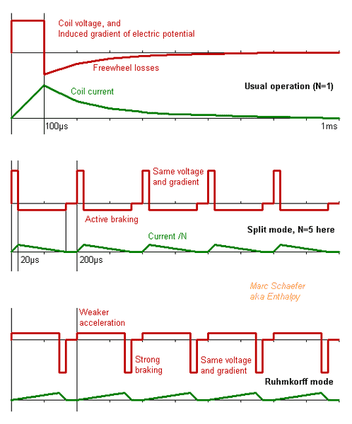

And here's a diagram intended to clarify the changes in the waveforms. Log in if needed, lick to magnify.
I've sketched N=5 for clarity, but real apparatus will probably use a bigger N.
Wave forms are idealized; real-life ones are smoother, and shall be so to protect the components.
I've written Ruhmkorff mode on the last waveforms, by analogy with an ignition coil, but terms like Forward and Flyback mode would sound more familiar to power electronics engineers.

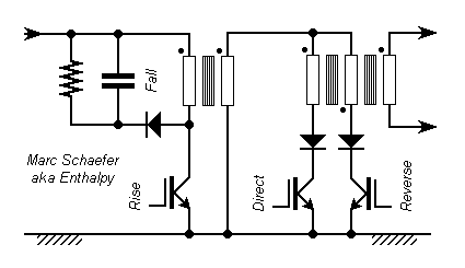

Referring to the circuit example sketched below (log in if needed, click to magnify):
An IGBT opened long before the pulse decides the polarity. The TMS coil could have been connected between these collectors, but the second transformer insulates the TMS coil and permits a direct gate control. A big E ferrite core suffices for such a transformer, so I feel this combination easier.
The left IGBT defines the rise time of the current pulse, and the supply voltage defines the rise rate.
On this sketch the resistor sets the current fall time in the coil. Operation at big N is meant to reduce losses in the TMS coil, but here most supply power is dissipated in the resistor. While this power is smaller than at N=1, and the resistor easier to cool than the TMS coil, one may prefer to reinject the energy in the supply. A third winding can help this, but since the voltage and current must already challenge the existing main switch technology, this winding shouldn't step up the voltage, so the power dump rail must have a lower voltage than the supply.
An adjustable power dump rail would control the fall time independently, and a braking voltage constant over the pulse may improve the TMS operation by limiting to a uniform plateau the induced electric potential gradient. The rail must accept and transform power but be pre-loaded before the first pulse. Several braking windings of different voltage ratios may help. I preferred to draw a resistor on the sketch :rolleyes:
At high N operation, hence with shorter commutation of a smaller current, MOS must be better than IGBT. Soft commutation (resonance) would be nice, except for the clarity of the sketch :rolleyes:
Marc Schaefer, aka Enthalpy

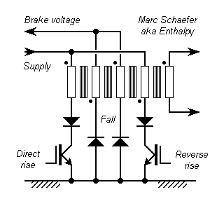

Up to now, supplied power increases the current quickly in a TMS coil, which must be the neuro-active phase when the induced electric potential gradient is strong, and a passive circuit let's the current decrease more slowly, in which phase I postulate the electric potential gradient must be below a threshold so it doesn't cancel out the effect obtained in the active phase.
If this model holds, the Flyback operation mode must produce the same result, where the powered phase increases the current slowly in the TMS coil, inducing a limited electric potential gradient, and the neuro-active phase brakes the coil current quickly to induce a strong electric potential gradient. (This must apply as well when the pulse is not split.)
In this other operation mode, the circuitry first supplies a moderate voltage to the coil to accelerate the current, then interrupts the current brutally, which results in a strong electric potential in the coil as well. Very similar to an engine's spark ignition circuit.
This operation mode seems advantageous:
  • The smaller electric potential gradient, which I suppose is the more delicate phase, is better controlled as it results from the supply voltage;
  • The brutal phase, when both U and I are strong, can flow in the circuitry through a diode, which is more robust than a transistor;
  • The circuit example here is simpler.

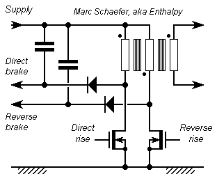

Referring to the circuit diagram sketched below (log in of needed, click to magnify):
The diodes and transistors must withstand the inductive overvoltage when cutting the current; the supply voltage is much lower, roughly in the same ratio as current fall and rise times in the TMS coil, for instance 10 times lower. The inductive overvoltage is defined through the brake voltage in this example.
The power supply provides less peak power now, but the brake circuit absorbs more, and the transistors must cut the full I at full U, uncomfortable. If the brake windings have as many turns as the accelerating windings, these windings can be coupled very closely to protect the transistors, and can even be the same winding - but with the same number of turns, the brake voltage is much bigger than the supply voltage.
A different choice uses fewer turns at the brake windings, and injects the brake current directly in the supply. This limits to a fixed ratio between the current rise and fall time, which can be switched if additional brake windings provide different numbers of turns. The transistors demand a separate protection then. Anyway, circuitry to protect the components (and preferably soften the transitions) is necessary, though not drawn on the sketch.

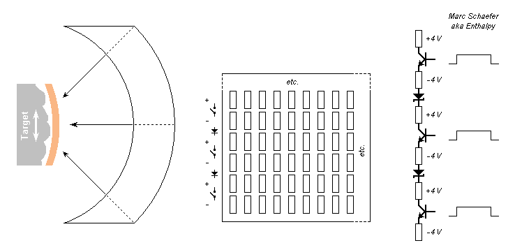

Here under is a coil enabled by the smaller current and induction: neither round nor flat. The turns are packed close where the effect is sought, and spread apart elsewhere to reduce the inductance.
Usual 8-shaped coils induce undesired potential gradients nearly half as strong under their return paths as under the central zone; the coil sketched here shall minimize them by placing the return paths farther away from the cortex, but near enough to reduce the effect of the main current path outside the central zone.
The angles of the turns (possibly more than 4, possibly of different sizes and shapes) should hence be optimized. I won't do it; a small software needs only to sum over the current path the contributions to the vector potential A to various positions at the target. The Biot and Savart formula is expected in the next message, and in
http://de.wikipedia.org/wiki/Biot-Savart-Gesetz
The active zone being ~45 mm long and the return paths ~85 mm, I estimate the inductance to 560nH with for instance 4 turns, using 4*500 nH/m where the turns are grouped and 1*500 nH/m where they're spread. To achieve the same 2,9 GA*turn/s as the 2* D70mm coil from Magstim fed with 2800 V, the design example takes only 725 MA/s and 406 V, and if the pulse's active duration is just 1µs, the peak current is only 725 A. Power components may prefer more turns.
The coil's wire consists for instance of commercial Litz wire (visual impression here under) of 33*Awg41 or 71µm individual wires. 7 such threads are twisted to a strand (for 2m in a lab, fasten them to the ceiling, put weights, and turn) and 7 strands to a conductor of 6.4 mm2 in D~4.5 mm, filled to 40%. Over the coil, 1.5 mohm DC resistance lose 2.8 mJ over one pulse of 1+10 µs * 725 A, while eddy currents lose roughly 1.6 mJ. Copper weighs 30g, so if hundred 1+10 µs pulses are one 0.1+1 ms pulse worth, the coil can absorb 2000 equivalents in 80K heating.
The cable may use the same 7*7*33* D=71µm conductors; 4+4 of them, insulated and braided, plus shielding and mechanical protection, make a 2 m bipolar cable. Copper weighs 0.91 kg; 2.8 mohm DC resistance loses 5.4 mJ and eddy currents some 1.8 mJ. The coil plus the cable lose 15mJ from a 150mJ pulse. Aluminium Litz wire would be highly welcome.
A pair of Toshibas's MG300Q1US51 - and certainly others - look capable of switching the pulse: 1200 V, 300 A, tr=50ns tf=100ns. The forward mode would reduce conduction losses in the IGBT. Regenerative braking reduces the supply's capacitors to ~1 dm3.

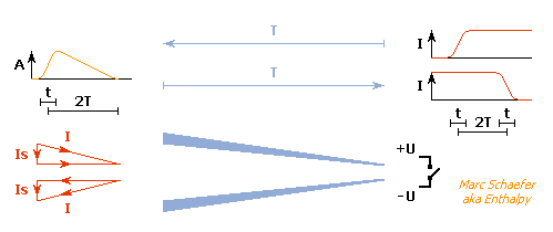

And here's the fourth picture needing a second message: Biot and Savart's law for the vector potential. You know, A, from B = rot(A). And mu/4pi is 10-7 in S.I.

With pulses like 70 ps long we leave the simpler near-field operation and magnetic coils. This is electromagnetic wave with antennas.
A strong short pulse followed by a weaker and longer compensation needs a wide band antenna, nevertheless directive and powerful. I sketch one possibility below (click to enlarge), where the rectangles are conducting elements meant to radiate.
The antenna comprises many dipoles side by side and butt, together with driving electronics. The shape should better approximate a section of a sphere; the dipoles can be driven with a slight time difference only, for fine steering, to compensate small tolerances, or to compensate diffraction at the target. The antenna has no reflector but can be backed by an absorber at some distance.
The dipoles are charged before each pulse; here resides the emitted energy. Each dipole has locally its own fast transistors to discharge it, for instance two BFG425W. The switch could also be behind a line, and possibly shared among several dipoles, but bigger transistors are uncommon at that speed.
Take dipoles 2* 20 mm long, wide to have 80 ohm wave impedance, charged at +-4 V. The transistors can reach the 50 mA in 30 ps; this constant current widens to 2* 20 mm within 70 ps, which defines the duration of the strong short plateau of induced electric field at the target.
10*12 dipoles at 200 mm distance would create in air the same field as present TMS apparatus with 3 GA/s. Permittivity at the brains and the cranial liquid reduces the field, and so do reflections at the scalp and the skull, but R2 times more dipoles, R times more distant, create a field R times stronger.
When the current pulse reaches the ends of a dipole, fast diodes (for instance three BAT62 per dipole) allow the current to continue flowing, due to the antenna's inductance, this time between butt dipoles. The current decreases more slowly, first due to losses in the transistors and diodes, say 1.2 V versus 8 V accelerating voltage, and second due to the finite length cumulated by butt dipoles. This defines the weaker longer plateau of induced electric field, maybe 6 times weaker here than the strong plateau. Less asymmetric than before, but still better than present TMS apparatus.
The dipole width or diameter can adjust the wave impedance a bit to match the components' current capability. They can't be too close, or their interaction will limit the current. The examples given are not optimum, especially the old diode is capacitive and slow (which cancels out partially). Stronger voltages would be very useful but MOS seem unavailable at this speed. I haven't checked other FET.
Driving the bipolars is difficult. I expect no charge gain per stage at 30ps, so the gain of the driving tree shall result from impedance transformation, but on a wide band and with floating voltages... Striplines similar to a gamma match, with ferrite for the bandwidth, and tapered to match the impedance?
70 ps make a pulse 20 mm long in air, which relates to the best field concentration at the target. This speed is difficult for components, and isotonic water has only 49 mm penetration depth at 5 GHz and 22 mm at 10 GHz.
Operation immersed in a water-like (or brain-like) material would improve a lot. It could use a liquid gel at the hair and a solid gel on the way from the antenna. 2 to 5 GHz limit the losses; the ~150 ps pulse is easier to produce even if stronger and is only 5.5 mm long in water, which improves the field concentration at the target and the size of the dipoles.
Immersed operation also reduces reflections, as only the skull has strong interfaces, and reduces imprecision due to refraction. Subtle beam synthesis by electronic steering can compensate the aberrations due to the skull, but this difficult option is more futuristic.
If the antenna doesn't touch the skull, the beam can follow the optically observed head's movements, by limited electronic steering, or by automatic control of the antenna's position.
