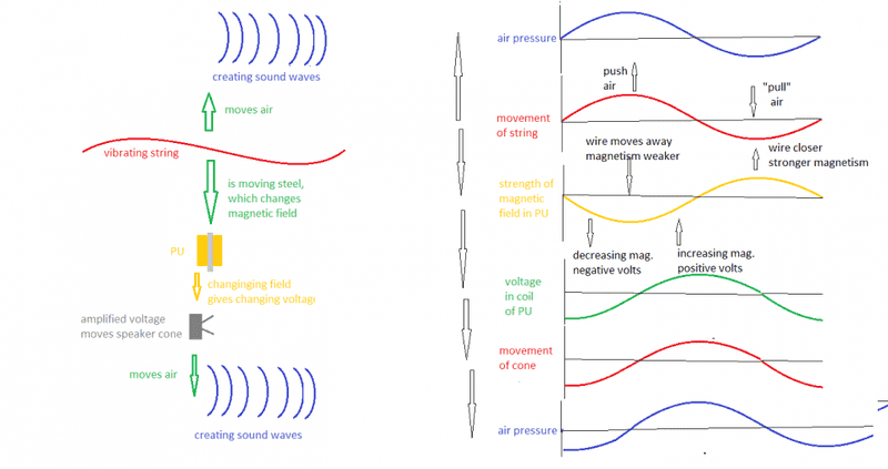

I've drawn something to try to illustrate what I said before.
1 - Movement of the string creates movement of air, either;
a) directly (acoustic guitar), or
b) by changing the magnetic field by the PU, which causes a voltage, which is amplified, which moves the speaker cone, which moves the air.
2 - By either method the way the air moves is effectively the same - fast vibrations produce fast changes in voltage, fast movements of the speaker and fast vibrations in the air (sound waves of high pitch.) Slow vibrations likewise produce slow vibrations in the air (sound waves of low pitch.) Big movements of the string cause big movements of the air (loud sounds) - in the case of the electric guitar, via big changes in magnetic field, big voltages and big movements of the speaker.
3 - The little "graphs" on the right are supposed to show the movement of the string relating to all the other things which are changing. It shows a "sinewave" which represents a single tone - for a higher pitch, the wiggles are closer, for a lower pitch, further apart. For a louder sound the wiggles are bigger, for a quieter sound, smaller. But however you vary it, the other elements in the chain vary in the same way -
more movement of string = more change in magnetic field,
more change in magnetic field = more voltage,
more voltage = more movement of the speaker cone
more movement of the speaker cone = more movement of air.
So whichever route you take, acoustic or electric, the movement of the string ends up as a matching movement of air. And vibrating movement of air is sound.
4 - As I put as a trivial footnote before, I've shown the wiggles may get a little out of step via the electric route. This is phase shift and and at this level of discussion makes no difference to what you hear.
5 - Tone differences are not shown here. The way the string vibrates is not the same at all points, so what the magnetic PU sees depends on its position along the string. It will generally be different from the vibrations picked up by the bridge in an acoustic guitar.
Windadct, Jim, Merlin
Thanks so much. This has to be one of the most friendly and helpful forums.
I think I understand now. Wind's answer got through to me and the others confirmed it. So it appears that the originator of the whole thing is the movement of the string and the relation between air and magnetic field is that they both get impacted by the same movements, so, it matters not that pickups did not "hear" air movement. The waves in the magnetic field carry the same thing/signature/whatever as the air waves. I think I can live with that. :)
Thanks again.

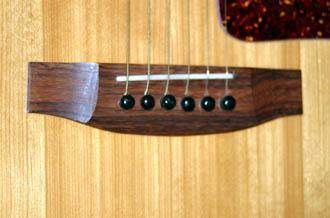

Merlin3189 said:
Obviously the bridge is the key, but isn't that, almost by definition, at a node for all transverse vibrations?
If there were no energy lost then the note would sustain for ever. Energy is, in fact, transferred into vibrations of the bridge so it isn't a perfect node. As you suggest, you can regard the bridge as a node with different positions depending on the frequency involved. However, with the sort of Q factor that you get with a vibrating string, the proportion of energy lost at each cycle, the "end effect" won't be very different. The same effect will occur at the frets but the lost energy will then go into the fingers. I imagine that a fretless instrument like a violin (which has a much shorter sustain time) must be affected much more by this - but the player would compensate by placing the finger appropriately. All these are second order effects, I guess, and allow us to differentiate between good and bad players. :smile:

If you ever watched guitar strings vibrate it's not only in the horizontal plane
i kept an old piano action for a while just out of curiosity. The strings go left-right, up-down, precess , and make interesting patterns.
Up-down component of motion will be transmitted via bridge into the thin wood top which acts as a diaphragm.
https://en.wikipedia.org/wiki/Bridge_(instrument)
Operation
A guitar's bridge holds its strings fast to the instrument; its saddle (white) raises them above the bridge and conveys their vibrations to the bridge. The black fasteners are called string pegs. All are "loose"—held in place only by string tension.
The bridge must transfer vibration to the sound board or other amplifying surface. As the strings are set in motion, it does this by bending to and fro along the string direction at twice the rate of the string vibration. This causes the sounding board to vibrate at the same frequency as the string producing a wave-like motion and an audible sound.
While helping my friend Harry work on old violins i saw they're more than just a resonant sound chamber underneath the strings
the bridge support is asymmetric and cantilevers motion into the top plate, and into the bottom one via a soundpost. Top also has a "bass bar" under the low frequency string (G?) i suppose to encourage it to vibrate as a large plate, and to make the bridge rock which flexes the top.
Next guitar i see open i'll look for its subtleties .
