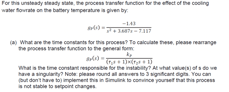

I don't know if I am just stupid, but I can't see how to make this manipulation. I tried factoring the denominator
$$ g_{p} = \frac {-1.43}{(s-1.399)(s+5.086)} $$
Then take out -1.399 and 5.086
$$ g_{p} = \frac {-1.43}{-1.399(\frac {-1}{1.399}s + 1)5.086(\frac {1}{5.086}s+1)} $$
But I know this won't work, and I am not clever enough right now to come up with the right way to manipulate this thing.

Your manipulations are correct; it is just that one of your constants ##\tau_i## is negative. If that is not allowed, there must be something wrong with the original ##g_p(s)##.
Likes gfd43tg
The negative time constant is allowed, which is what makes it unstable. My algebra is weak, so for some reason I had it in my head that if I multiplied my result out, I would come up with something different from the original transfer function!

You've almost got the form of gp(s) that is specified, you just need to combine all the constants in the numerator and the denominator.
Hint: kp ≠ -1.43 in the final form.
