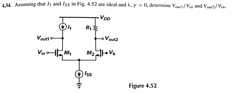

[Taken from Razavi's Design of Analog CMOS Integrated Circuits 2nd edition]
[/B]
I'm not too sure what to do with this question. Here's what I think of the circuit
This doesn't look like a differential amplifier to me since there's only 1 input. From what, I see, M1 has a constant DC bias current through it of I1. I see the following relationship
$$I_2=I_{SS}-I_1$$
Leading to,
$$V_{out2}=V_{DD}-(I_{SS}-I_1)R_1$$
Note that I2 is the current through R1 and M2
As Vin small signal changes, this I1 is perturbed, which in turn perturbs I_2 which in turns adjusts voltage drop across R1 which leads to Vout2 having a small-signal change. Now, I'm not sure how to get Vout1/Vin or Vout2/Vin. I was thinking of maybe adjusting the equation up there and sub in the Id equation for I1 but that would leave me with a quadratic and squared Vin term.
Also if there's any experienced analog people out there. Is my thought process correct for understanding the circuit or along the right lines?

CoolDude420 said:
As Vin small signal changes, this I1 is perturbed, which in turn perturbs I_2 ...
But you are given that I1 is an ideal current source. That means it is a constant current regardless of Vin and Vout1, so changes in Vin cannot "perturb" I1.
Hmm good point. In that case then, I have another question. What about like a standard CS source stage with a current source like this
How do these circuits operate then?
If M1 between D and S appears as a variable resistance controlled by VGS then the voltage across that varying resistance, VDS, can vary even while ID is held fixed.
CoolDude420 said:
Hmm good point. In that case then, I have another question. What about like a standard CS source stage with a current source like this()
I1 doesn't change, but Vout does change as a function of Vin.
In your original circuit, I didn't say Vout1 doesn't change. It does change as you change Vin.
