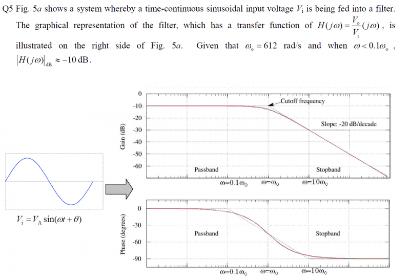

Determine the transfer function of the system H(jw)
why the answer is not 1/[1+(jw/612)] but equal to 0.318/[1+(jw/612)]?
to which equation?Vi=Va sin(wt+θ)?LvW said:What happens if you insert w=0 into the equation? Can you determine the remaining value?
but the equation of H(jw)=1/[1+jwRC] (from my lecture notes) 1/Rc=w0 (for w<0.1w0), hence i did not where 0.318 come fromLvW said:You have asked for the transfer function - thus, I mean H(jw), of course.
20log(Vout/Vin)=-10LvW said:The magnitude plot shows for small w values (down to w=0) a level of -10dB. Can you calculate the corresponding absolute value?
Then, you must compare this result with both transfer function for the case w=0. Which one is valid?
NO,they are not the same ,for the equation of 1/[1+jw/612] 丨Vout/Vin丨=0.999998, but how can i make it become 0.316?LvW said:Don`t you see it in one of your transfer functions?
sorry,still don't understand can you show me some step ?LvW said:I repeat: Don`t you see it in one of your transfer functions?
from the graph (a) 0 to w0 ≅-10dBLvW said:At the bottom of your first post I see TWO functions.
Are you able to insert w=0 into BOTH functions - and decide, which one results in 0.318?
Some of the filter's attenuation is not frequency dependent. Its "Gain", "Attenuation", "Transfer Function" , call it what you like ,kenok1216 said:丨Vout/Vin丨=10^(-0.5)=0.316? then what is the meaning of this number
for the equation of 1/[1+jw/612] 丨Vout/Vin丨=0.999998 they are not the same,then how can i solve this problem?
kenok1216 said:why the answer is not 1/[1+(jw/612)] but equal to 0.318/[1+(jw/612)]?
Jony130 said:First find the "DC gain" (for w = 0) for this transfer function 1/[1+(jw/612)]
Next do the same for this one 0.318/[1+(jw/612)], then you need to compare the results. And you will see that only one of the results will fits the "graphical representation".
jim hardy said:as explained above, it's K X f(frequency) ,, 0.316 X 1/[1+(jw/612)]
LvW said:Sorry - I resign. Are you kidding me?
kenok1216 said:1/[1+(jw/RC)
Hi Jim - perhaps you are right in some cases, however, after 25 years experience in teaching electronics, I know about the problems some beginners might have.jim hardy said:Sometimes teachers forget how strange it all seems to beginners.
LvW said:however, after 25 years experience in teaching electronics, I know about the problems some beginners might have.
I don't see where you're guilty of that.LvW said:and sorry for the misunderstanding I have caused.
I bet yours would work a lot better...LvW said:Perhaps I should try to repeat this procedure?
