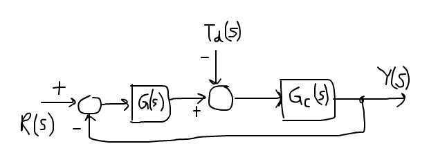

Transfer function with Disturbance
In summary, the problem is to find the steady-state error due to a disturbance Td(s) = 1/s when R(s) = 0. The student is trying to find Y(s)/Td(s) by obtaining Y(s) in terms of the transfer function Y(s)/R(s). However, since R(s) = 0, the transfer function is not valid for Td(s). The student is unsure how to proceed and is questioning why R(s) disappears in the solution.
TheNovice
Find the steady-state error due to a disturbance Td(s) = 1/s.
Set R(s) = 0.
if given a system:
n/a
I need Y(s)/Td(s). To do this I must find Y(s) in terms of the transfer function Y(s)/R(s) which I have obtained. This gives me an expression for Y(s) in terms of G(s), Gc(s), and R(s).
3D%20R%28s%29%20%5Cfrac%7BG%28s%29G_%7Bc%7D%28s%29%7D%7B1%20+%20G%28s%29G_%7Bc%7D%28s%29%7D.gif
Now I must solve for Y(s)/Td(s).
If Td(s) = 1/s, then I should just multiply Y(s) by s and be done with it. However, the book gets a totally different answer.
specifically, I am not sure how R(s) disappears along with the rest of the numerator in the result.
Thanks for your time.
Set R(s) = 0.
if given a system:
n/a
Why? R(s) = 0!
Your transfer function is valid for the R(s) input only.
The function referred to the Td(s) input looks different!
