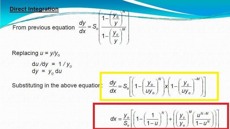

I need help when changing the formula of the yellow circled part to red-circled part ...

I cannot make sense of the text either. It looks quite wrong. Certainly a du has been omitted from the right hand side, and I cannot see how that 1-u term can appear. Perhaps the N exponent is in the wrong place. Maybe some approximation has been made, but that should be stated.

The closest I can get is ##\frac{y_0du}{S_0}[\left(1-\frac {1}{1-u^N}\right)## ##(1-(\frac{y_c}{y_0})^Mu^{-M})^{-1}]##.
If we use the binomial approximation for the last (...)-1 term, we get:
##\frac{y_0du}{S_0}[\left(1-\frac {1}{1-u^N}\right)## ##(1+(\frac{y_c}{y_0})^Mu^{-M})]##.
Multiplying the brackets out produces something quite close to the text. The remaining differences look like typos.
