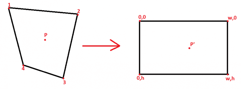

I need some sort of transform that maps points from any quad to an rectangle. I will be using this on a computer graphics software, so you can think of this rectangle as my viewport or something like that.
Below is an image to illustrate the problem:
The points 1, 2, 3 and 4, and the w and h values are parameters. The point P is the input, and I'd like to know P'. The point 1 should map to (0,0), the point 2 should map to (w,0) and so on...
Sorry if this is confusing. Please tell me if you need more information.

Why do you want to map between a rectangle and an arbitrary quadrilateral for graphics? The most dramatic transformation I can think of for graphics is from rectangle to trapezium, which has two parallel sides. The loss of parallelism of the other two sides comes from perspective.
I imagine there is a natural way to map from rectangle to trapezium, that uses the laws of perspective. It should not be too hard to work that out. There is no natural way to map a rectangle to an arbitrary quadrilateral. There may be multiple ways possible, that would provide different answers.

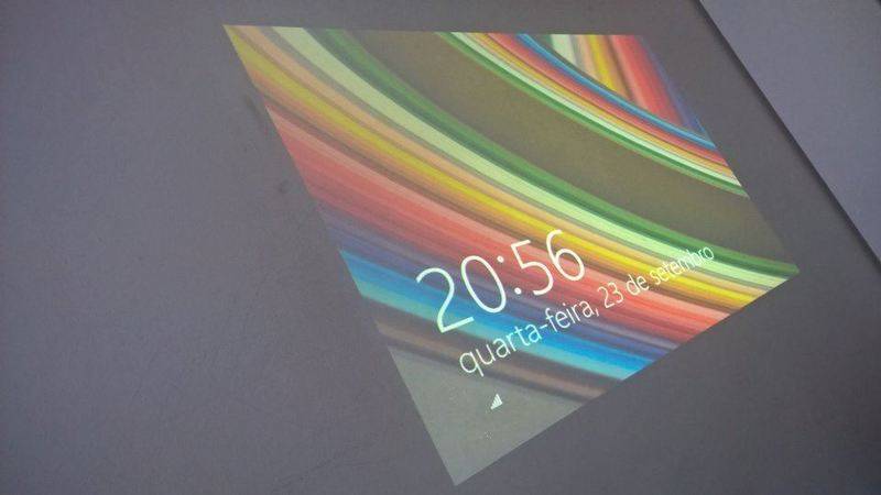

To make things more clear, this problem is going to be used on a computer vision technique. I want to be able to map pixels from a projection (edit: NOT EVERY PIXEL, just one point at a time. I don't want to obtain an undistorted image from the camera, I want to obtain a mapping from the camera to screen coordinates), obtained from a camera, into an actual viewport. Here is an example of an image obtained of a projection by a camera:

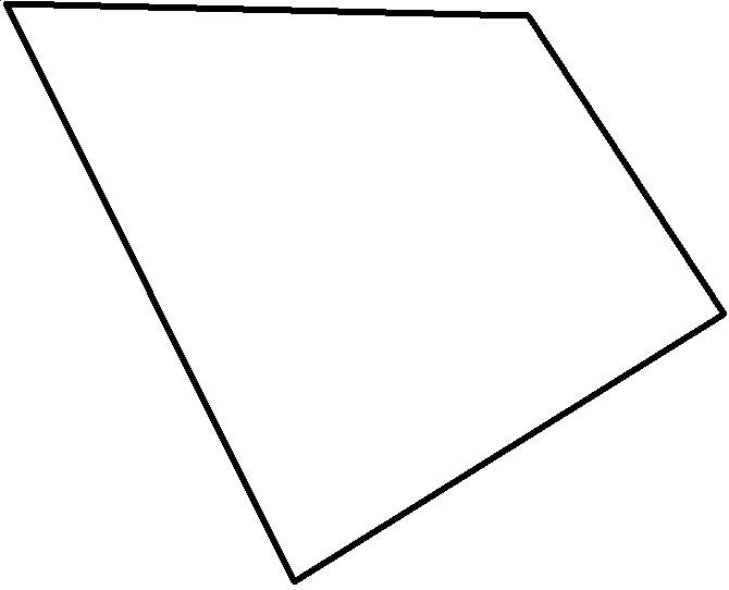

The image projector may not be perpendicular to the white screen, which would generate images with different perspectives. Also, the camera may be in any position, capturing the image. As you can see, the outline has no parallel sides:
OK, that makes sense. Note that this is not just 'any quad' but a very particular one that is defined by the laws of perspective. Amongst other things it excludes concave quads. Your picture suggests a nice natural way of doing the mapping.
The quadrilateral is the intersection of the spaces between two pairs of rays, where the members of each pair meet at infinity in the distance. Those two infinite points can be given coordinates in the flat screen frame - which will probably be off the screen, but that doesn't matter. Using those two 'infinity' points as centres for measuring angles enables us to define a natural coordinate system for the quadrilateral.
First, using a Cartesian coordinate system for the screen, get the equations of the lines in which the quad's four sides lie. Then find the screen co-ords of the two points at which the lines from opposite sides intersect, call them O(1) and O(2). They wil probably be off the screen, but that doesn't matter. Call the one that is first in an anticlockwise direction from the top left corner of the screen O(1). Each has two diverging rays emanating from it that pass through two opposite sides of the quad. Let t(i) be the angle between the two rays of O(i) that sweeps out the quad. It will be less than 180 degrees.
Let l(i,1) label the first and l(i,2) the second of the two rays from O(i) when we sweep out the quad from O(i) moving in an anticlockwise direction.
Now we can give coordinates for every point in the quad. For every point P in the quad, define its 'angle coordinates' as (a(1),a(2)) such that a(i) is the angle that O(i)P makes with O(i)l(i,1).
Now we just map the point with angle coordinates (a(1),a(2)) to (L(1)*a(1)/t(1), L(2)*a(2)/t(2) ) in a Cartesian coordinate system for the rectangle where L(1) is the true length of the rectangle side that is first encountered by the rays from O(2) and L(2) is the true length of the rectangle side that is first encountered by the rays from O(1) and the direction of the two coordinate axes for the rectangle corresponds with the direction of the angle coordinates for the quad. Note that this coordinate system may not be the same as the one in your diagram above.
I think the mathematical manipulation for this will be quite straightforward, and may not even need matrices.
Addendum. If a pair of sides of the quad is parallel, a point of convergence O(i) at infinity will not exist, so we modify the approach by replacing L(i)*a(i)/t(i) by d(i) where L(i)*d(i)/M(i) is the distance of the point from the lower of the two sides (or the leftmost, if the sides are vertical) and M(i) is the distance between the two sides in the quad.
This can happen for one or two pairs of sides, but if it happens for both, the quad will already be a rectangle, so no transformation is needed (I'm pretty sure there's no way one can get a parallelogram shape from a rectangle via perspective).
