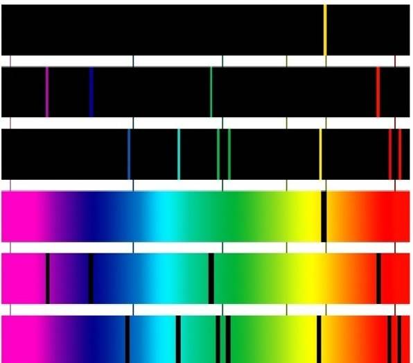

I propose a concept in which the basis for working with information (conservation, transmission in networks) is to use spectral atomic and molecular analysis. Transform the periodic table of chemical elements (periodic table) into a universal way of storing and transmitting information using spectral analysis.
Having completed the assembly in a small physical volume (information carrier) of a set of chemical elements, information can be stored on the carrier and subsequent decryption using spectral analysis, the information is coded taking into account the chemical elements of the periodic system (Periodic Table).
For example, you can put information in a small amount of metal alloy with a specific composition and mass of various chemical elements and use spectral analysis to read the information. This method of atomic-molecular analysis of the spectrum of elements can increase the amount of information transmitted in multiplexed communication channels.
This method of transmitting information is probably not yet used in fiber optics; I have not found any examples of using this concept for storing and recording information. Compact spectral analyzers receiving data volumes about the objects of analysis can theoretically transform the periodic table of chemical elements into another type of data.
I occasionally had to work on my specialty with portable spectrographs for the analysis of materials. So the idea came about transforming the data on the display of the spectrograph into another kind of information. into a universal way of storing and transmitting information using spectral analysis.

There are some obvious issues with the overall idea, like many elements are not going to mix well together, and gasses won't stay in one place, etc.
But the idea of encoding information in spectra may be interesting. I don't understand what you are saying about the container -- wouldn't you want the elements/compounds to be spaced out along a strip or distributed on a 2-D surface? If they are all mixed together, then your ability to encode information would seem to be limited, no?
Unless you could put the elements in sequence, the number of useful messages would be very limited.
Suppose you try to read a book with an analog of spectral analysis. The analysis might tell you that the book contains 1% A, .5% B, 1.1%C, .6% D, 4% E, and so on.
It would be much easier if the data was first divided into words rather than a whole book. Even so, could you write a book using only the counts of how many of each letter appear in each word without specifying the order of the letters?
2a + 2p + 1e +1r could be "appear" or "pap ear" or other anagrams. And with spectral analysis you might not even be able to say there are two letter As, but just that there are some As.

The time it takes to make a spectrum, and the time it takes to read it, delays the transfer of information. A spectra would require several GHz of bandwidth be stable for some time to carry and convert the information, equivalent maybe to a billion bits per spectral sample.
A real spectrum is complex and confusing with many redundant and several coincident lines. A much simpler code, such as binary, would store more information for lower cost in a lower bandwidth channel. If the same spectral bandwidth was used, the encoded information could be increased significantly again.
To understand the spectral problem. Imagine a 16 bit integer, usually transmitted as 16 bits only. If it was transmitted as a frequency it would take 65,536 cycles before the same accuracy could be achieved in estimating the frequency. Binary is 2^16 / 2^4 =4096 times faster than a spectra.
To make up the difference you must transmit 4096 spectral channels in the same channel, all at the same time. If you used real spectra it would be an inefficient mess with unused space and overlapping data, but if instead you used an FFT to convert the data in an orderly way you would have the same modulation as used now for digital TV distribution = OFDM.
Spectral methods work, just not with real chemicals or spectra.
