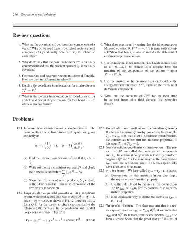

TL;DR Summary
I wanted to clarify some things on the transformation of contravariant and covariant components of a tensor given the fact that I have viewed many articles and post here.
I have read many GR books and many posts regarding the title of this post, but despite that, I still feel the need to clarify some things.
Based on my understanding, the contravariant component of a vector transforms as,
##A'^\mu = [L]^\mu~ _\nu A^\nu##
the covariant component of a vector transforms as,
##A'_\mu = [L^{-1}]^\nu~ _\mu A_\nu = [L]_\mu~^\nu A_\nu##
Note that ##~[L^{-1}]^\nu~_\mu = g^{\nu \alpha} g_{\mu \beta} [L]^\beta~_\alpha = [L]_\mu~^\nu##.
So based on this, it is my impression that all LT and inverse LT matrix must be written so that their indices are like this ##^\mu~ _\nu## and only when you want to rewrite the inverse LT as an LT then you realign ##_\mu~ ^\nu##.
This is what I think until I read Cheng's GR book.
For the review question 3 & 4, why did he write the covariant transformation in that way ##_\mu~ ^\nu##?
The index placement looks odd to me in places throughout that. For example, the third rank tensor is shown as ##T^\lambda_{\mu\nu}##. Perhaps it's a notation scheme I'm unfamiliar with, but it was my understanding that you have to keep track of which index was raised. That is, I understand ##T^\lambda{}_{\mu\nu}##, ##T_\mu{}^\lambda{}_\nu## and ##T_{\mu\nu}{}^\lambda## as the same tensor with different indices raised, but it's not clear to me which index is supposed to be raised in ##T^\lambda_{\mu\nu}##.
I don't have the book so I cannot investigate myself. Is it possible there are just some typographical issues here?
I totally agree with what all you said. Looking at the errata sheet for the book and scanning the whole book, that seems not to be a typo but a notation used throughout, which I think is confusing hence my post.
The index placement is indeed very important and in #1 it's correct. You must make sure to have the indices located right in both horizontal and vertical placement. The example notation in #2, ##T_{\mu \nu}^{\lambda}## is thus useless and meaningless. I guess it's the inability of authors to use the tensor package properly in LaTeX, and nowadays publishers don't care about typography but simply take what the authors provide (sometimes even distorting it in the process, as anybody knows who publishes in standard physics journals ;-)). For this reason I'd not recommend the use of this book from just looking at the two example pages given in #1. Maybe it's a good exercise to repair all the sloppy notation, but to start learning a subject with such a sloppy source is not a good idea, if you ask me.

Can you clear it up to me what I should interpret as row or column in the indices? For example
##[L^{-1}]^\nu~_\mu = g^{\nu \alpha} g_{\mu \beta} [L]^\beta~_\alpha = [L]_\mu~^\nu##
In ##~[L^{-1}]^\nu~_\mu~## ,##\nu## is the row and ##\mu## is the column.
How about in ##~[L]_\mu~^\nu##? Still ##\nu## is the row and ##\mu## is the column right?
Such that,
##A'_\mu B'^\mu = [L^{-1}]^\nu~_\mu [L]^\mu~_\lambda A_\nu B^\lambda = \delta^\nu~_\lambda A_\nu B^\lambda = A_\nu B^\nu##
where the column ##\mu## of ##[L^{-1}]^\nu~_\mu## is summed with the row ##\mu## of ##[L]^\mu~_\lambda##.
But what if I use ##[L^{-1}]^\nu~_\mu = [L]_\mu~^\nu##, so that
##A'_\mu B'^\mu = [L]_\mu~^\nu [L]^\mu~_\lambda A_\nu B^\lambda = \delta^\nu_\lambda A_\nu B^\lambda = A_\nu B^\nu##
I am not sure if I placed the indices in the ##\delta## correctly since both ##\nu## and ##\lambda## are on the right side of the placement. Please clarify my questionS
You should first understand that transformation matrices are not tensors, and their indices don't mean the same thing as tensor indices.
Likes AmaroJuuulianoni and vanhees71
Yes, like the LT matrix is not a tensor, but can you expound on what you mean?
In the matrix notation of "objects" with two indices the first index labels the rows and the second one the columns. You cannot so easily distinguish upper and lower indices. As your posting shows, there's no need for the matrix calculus. Everything works out with much more safety in the Ricci calculus with indices, where you have clear transformation properties due to the notation with upper and lower indices for contra- and covariantly transforming components.
Your calculations look all good. For the ##\delta## (Kronecker symbol) the "horizontal order" is irrelevant, because it's symmetric, i.e.,
$$\delta_{\mu}^{\nu}={\delta_{\mu}}^{\nu} ={\delta^{\nu}}_{\mu}=\begin{cases} 1 &\text{for} \quad \mu=\nu, \\ 0 & \text{for} \quad \mu \neq \nu. \end{cases}.$$

If you want to use the matrix notation (which I'd not recommend in general, but it sometimes can shorten some calculations) then you have to stick to the rules, i.e., in a matrix the first index numbers the rows, the second the columns, no matter whether they are upper or lower indices. So you have to clearly specify which "index pattern" you associate with your matrix. E.g., for the Lorentz-transformation matrix usually one defines
$$\hat{\Lambda}=({\Lambda^{\mu}}_{\nu})$$
and for vectors you write a column
$$\underline{V}=(V^{\mu}).$$
Then the transformation rule under Lorentz transformation reads
$$\underline{V}'=\hat{\Lambda} \underline{V}.$$
Further for the metric components
$$\hat{\eta}=(\eta_{\mu \nu})=(\eta^{\mu \nu})=\mathrm{diag}(1,-1,-1,-1).$$
Then the Minkowski product reads
$$U \cdot V=\underline{U}^{\text{T}} \hat{\eta} \underline{V}.$$
Then from
$$\underline{U}^{\prime \text{T}} \hat{\eta} \underline{V}'=\underline{U}^{\text{T}} \hat{\eta} \underline{V}$$
you get (since it should hold for any ##\underline{U}## and ##\underline{V}##) for the Lorentz-transformation matrices
$$\hat{\Lambda}^{\text{T}} \hat{\eta} \hat{\Lambda}=\hat{\eta}.$$
multiplying with ##\hat{\eta}## from the right and with ##\hat{\Lambda}^{-1}## from the left yields
$$\hat{\Lambda}^{-1} = \hat{\eta}\hat{\Lambda}^{\text{T}} \hat{\eta}.$$
For the transformation rule of the covariant components note that the covariant components given as a column are ##\hat{\eta} \uvec{V}##. For the corresponding transformation matrix ##\tilde{\Lambda}## you want
$$\hat{\eta} \uvec{V}'=\tilde{\Lambda} \hat{\eta} \uvec{V}=\hat{\eta} \hat{\Lambda} \uvec{V} = (\hat{\eta} \hat{\Lambda} \hat{\eta}) \hat{\eta} \uvec{V}$$
and since this should hold for all ##\uvec{V}##
$$\tilde{\Lambda} = \hat{\eta} \hat{\Lambda} \hat{\eta} = (\hat{\Lambda}^{-1})^{\text{T}},$$
i.e., the covariant components transform contravariantly to the contravariant components as expected.
