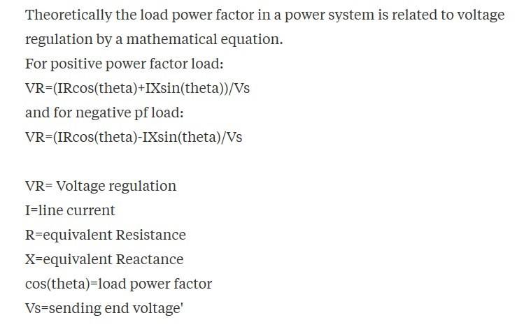

Here's a little snippet from https://www.quora.com/How-power-factor-of-load-effects-voltage-regulation
Looks like you need to find what the Power Factor is.

In my opinion, a power factor is always positive. But X could be negative if it is capacitive. Fortunately, in your case the reactance is inductive that means positive.
Let's say the high voltage -10 kV- does not change with the load so what you have to do is to calculate the total impedance-viewed from primary terminals-and to divide the primary voltage by total impedance in order to get the current. Power factor will be the resistive part divided by total.
Do not forget to transfer the load impedance from secondary to primary side.
Likes Omar7177
Yep, that's pretty much the way I did it, and I've got the answer. Thanks!:biggrin:
