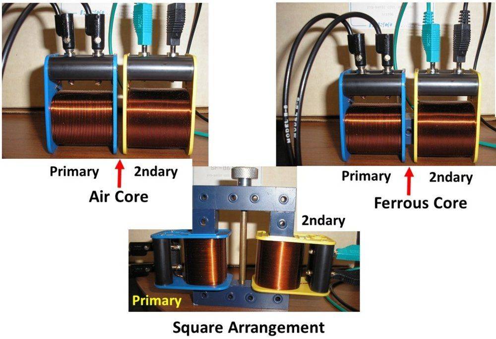

The primary is input with a sine wave from a Tektronix Function Generator AFG 1022 of about 2.0 volts peak-peak (which doesn’t always mean 2 volts peak-peak on the oscilloscope). I measure both waveforms from the primary and secondary (labelled 2ndary) with a Tektronix TDS 1002B oscilloscope. The step-up transformers I have tried are A) 200 turns to 400 turns, B) 200 to 800 turns, and C) 400 to 800 turns. I tried the following configurations in the picture: Configs_Tried.jpg
In each configuration I went from 100 Hertz to 500,000 Hertz. Usually, the single frequency in which the transformer relationship above held occurred somewhere between 50,000 and 200,000 Hertz. The best working configuration (see the file above "Configs_Tried.jpg" for what my transformer labels mean) for this result was when the two coils shared just a “Ferrous Core” between them; neiither the “Air Core” or “Square Arrangement” worked very well for verifying the transformer relationship above. Below, you can see the only frequency for the “Ferrous Core” configuration at a frequency of 121,000 Hertz in which the transformer relationship above holds in the file: "OutputScopeTrans,jpg"

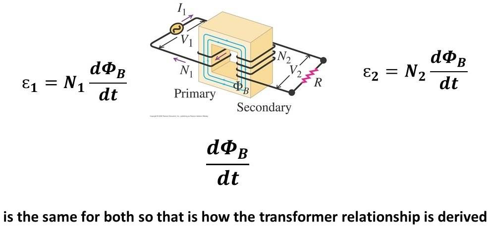

The proof is in any standard physics with calculus textbook for engineering majors. Basically, in Young and Freedman, University Physics, I attach the following proof. It looks like every book at this level offers the same proof.
That is, by sharing the bar magnet in this "square configuration", the flux changing through one arm is the same as the flux changing through the other arm of the transformer, and that yields the "transformer equation" I began in this post. However, this configuration did not work well when I actually tried it. Note that there is nothing about frequency limitations in this (way-too) simple proof.

From the web page.
Note:
These are not ideal transformers. As is true for any transformer using separate coils (coils that are not coaxially wound on the same core), the flux linkage between coils is only about 10%. The voltage transformation ratios are therefore proportionately below the ideal values based on the number of turns per coil. Within this limitation, effective quantitative investigations can be conducted using these coil and core sets.
I'd expect the coils are probably meant to be used with power-line frequency. 50 or 60 Hz. The best results would no doubt be with the metal core. At the frequency you use it the output impedance must be really high, and the output voltage would likely mostly disappear with a realistic load.
Many transformers are only designed for those frequencies. Audio transformers do exist however. 500 kHz is well above the maximum frequency however. You might hope for the -3dB point (50% power) at 20 kHz. Higher frequency transformers need lower inductances, and a ferrite core, which won't conduct eddy currents.
