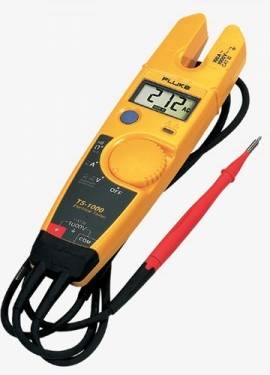

And what kind of meter are you using to measure volts and amps? Some are fooled by non-sinewave like produced by chopper supplies.

i measured voltage across the element with an ordinary fluke meter set to V (does both AC/DC) and measured amps with the same meter at the point on the cable just before it connects to the element (meter has notch in the end to measure amps)... both powerpacks have CT's and Ammeters on secondary side as well...

Have you a photo of that powerpak?
now THAT's interesting - what's its model number ? I'd like to read up on it.
Aha think i found it Fluke T5 ?
its spec sheet says 45 to 66 hz for AC and it's average responding
http://www.myflukestore.com/pdfs/ca...fluke_t5_1000_electrical_tester_datasheet.pdf
Not indicting it, just exploring its limits.
I assume you're working at 50 or 60 hz.

the Fluke T5 tells you whether it sees AC or DC voltage, without a clue in datasheet as to how it decides which to report if both are present. i assume he sees AC reported since he speaks of a transformer.
T5's current measurement is AC only though.
i also assumed he's got a T5 since it's the only thing on Fluke site that resembles his description.
http://www.fluke.com/fluke/m3en/electrical-testers/Electrical-Testers/Fluke-T5-600.htm?PID=74729

So one question is, what could make a meter that is measuring a phase angle modulated AC waveform report higher than actual volts and amps ?
From T5 customer reviews at Amazon:
(Gripe)#2 is that if you had ever had to trouble shoot a lower voltage like 24v dc the meter will show the highest reading in which sometimes there are phantom voltages that will show like say 30 vac but negligible voltage on dc.
try an analog meter

where to start... yes, used a T5 meter to measure AC output from PP... PP setups are identical apart from component ratings (also rewired larger pp equipment to feed smaller pp transformer to confirm that the transformer is the problem)...
