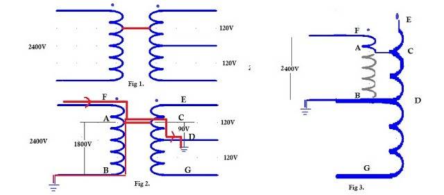

The transformer primary to secondary short was quite challenging and interesting.
Look at these figures.
In Figure 1. There is a short between 1/4 of the primary to 1/4 of the secondary. In this case, the grounds aren't connected. Nothing happens here. Nothing.
In Figure 2. There is same short, but ground is connected. The voltages are shown at the instant of shorting. Since there is a huge voltage difference, heavy current will flow for some time, sparks may arise. But the condition won't las long.
The red lines shows the path of steady state primary currents, Because the path CD and AB are parallel, current will divide. But CD is made of up few turns of heavy secondary, almost all currents will flow through CD effectively shorting out AB.
Figure 3. (This is actually Figure 2 twisted and turned) Since AB is irrelevant as it shorted out by CD, it is shaded gray. Now we effectively have a auto-transformer. From the original spec, we can say that the primary has now nearly 1/4 of turns of original. So, we can calculate that the secondary voltage of the on-shorted part DG.
I have calculated V(dg) = 480 V (approx).
Ask, if you are interested.
Okay. You're saying that we now have 2400V between C and D, since this is now the path that the primary takes. This part makes sense.
So the DG voltage is now 1/2 of the remaining 2.5:1 (2400/2.5=960) transformer that is still in place. Since we'd only have half of this voltage (960/2=) we see 480V.

Hmm, not quite, but it was interesting that you arrived at 480V somehow! :)
We don't have 2400V between C and D.
We have 2400 V between F and D.
So we have 2400 V as primary. How many turns does the primary have?
Primary Turns = Turns in FA + Turns in CD == Turns in FA approx. (Turns in CD << Turns in FC)
Turns in FA is 1/4 of the original turns.
So, effectively, the Turns in primary has been decreased to about 1/4 of original
So, we get 4 times the original voltage in DG = 4*120 = 480V.
(You can do more accurate calculation by taking into account the turns in CD as well)
However remember that, you can't run a the transformer like that and obtain and use 480V in secondary, because, the core in Transformer is designed to used for the original no. of turns. You can't change (decrease) the no. of turns from the original design. It will result in excessive core losses.
Edit: Voltage across CD = 1/2 Voltage across DG = 240 V.

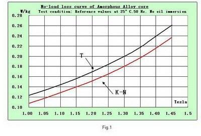

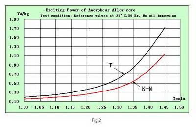

This will lead to more than 4 times in increasing in Iron Loss, may be resulting in Red-hot Core! :P
Also, as the core is pushed deep into saturation, it will consume huge magnetizing currents .In this case, I guess more than 10x increase. (No-Load Currents). This will result in excessive copper loss. May be resulting in red-hot copper. In fact due to huge magnetizing currents, there will be large IR drop due to copper resistance in Primary, so, ineffect, we won't get that 480V in secondary (which was obtained by ignoring no load current, which can't be done in our drastic condition!). I guess the secondary voltage will be around 400 V
So, we see that the transformer will be heated excessively so sure the transformer will be completely damaged if left like that for some time. So, may be after some time the enamel of the conductor of primary melts away and direct short may result, deteriorating the condition even more. I don't know whether there will be an explosion, though!
These Curves will help Estimate the Increase In Iron Loss (W/Kg) and Increase in No-Load Currents, when the Flux densitiy is increase 4x. Take original Flux Density to be 1.4 T and New Flux Density = 4*1.4 T
