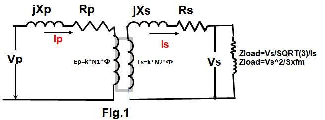

sqrt(3)*Irat*[Rtrf*cos(fi)+Xtrf*sin(fi)] -it is an approximate formula but the error is negligible.
I think the job it is to find a supplementary resistance to be inserted in the secondary [11 kV] in order to achieve 2% regulation.
We cannot separate the resistance of the secondary from primary-this 0.01 ohm it is the equivalent resistance across the transformer:
Rtrf=Rpr+R'sec R'sec=Rsec*0.415^2/11^2

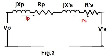

If the voltage regulation is 2% that means 2%*415=8.3 V [line-to-line]
The new resistance viewed from primary side[415 V] has to be:
New Rtrf=DV/sqrt(3)/Irat-Xtrf*sin(fi) fi=0 [cos(fi)=1]
Irat=200/0.415/sqrt(3)=278.24 A
New Rtrf=8.3/sqrt(3)/278.24=0.017223 ohm
The new inserted resistance will be 0.017223-0.01=0.007223 ohm
Viewed from 11 kV the -actual- resistance will be 11^2/0.415^2*0.007223 =5.0747 ohm.

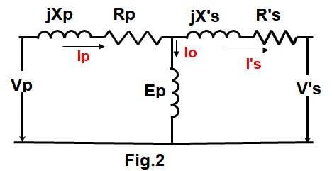

Look at it this way: assume primary current = ip.
Then primary resistance power loss is Pp = ip2 Rp
But if we reflect into the secondary the power loss must be the same: Ps = is2 Rs.
But is/ip = N1/N2 so Ps = (N1/N2)2 ip2 Rs = ip2 Rp.
So Rp = (N1/N2)2 Rs
or Rs = (N2)/N1)2 Rp. For your step-up transformer, (N2/N1) = 702.56
so Rs = 702.56 Rp.

The actual transformer diagram it is as in Fig.1
Let’s put E's=Es*N1/N2=Ep and V's=Vs*N1/N2
N1/N2=Vprat/Vsrat at no-load.
Zk=Rtot+Xtot*i i=sqrt(-1) and it is measured when secondary terminals are short-circuited and the current stays rated transformer current.
Since the power Sxfm transferred through magnetic field remains the same:
E's*I's=Es*Is I's=Is*Es/E's=Is*N2/N1
Voltage drop at secondary windings will be:
DV=Es-Vs then D's=E's-V's
Now if D'Vs=DVs*N1/N2 then Z's=D'V/I's=DVs/Is*(N1/N2)^2
R's=Rs*(N1/N2)^2 and X's=Xs*(N1/N2)^2
And now we can draw the diagram Fig.2
Since Io is negligible you may draw the Fig.3
So the total resistance viewed from primary side it is:
Rtotold=Rp+R’s=Rp+Rs*(N1/N2)^2
or if we shall add a supplementary resistance :
Rtotnew=Rp+ Rs*(N1/N2)^2+Rnew*(N1/N2)^2
Rnew=(Rtotnew-Rtotold)*(N1/N2)^2
The regulation is the voltage drop for a certain cosfi[p/f.] and current.
DVtot=sqrt(3)*Iload*[Rtot*cos(fi)+Xtot*sin(fi)] and since cos(fi)=1 sin(fi)=0
DVtot=sqrt(3)*Iload*Rtotnew

So I have ##R_p = \sqrt {0.01^2 + 0.057^2}## which is ##0.05787 \Omega##
Multiplied by ##n^2 (702.569)## is ##40.658\Omega##
With a secondary output of 11kV and a 200kVA rating, the (max) current is 18.1818 Amps.
With a voltage regulation of 2%, I have 11kV * 0.98 which is 10.78kV (across the load).
Therefore, we have 220v (11kV - 10.78kV) dropped internally. As ##Z = \frac{V}{I}## then ##Z = 12.1\Omega##
With a max current of 18.1818 Amps, the total circuit impedance is ##Z = \frac{11,000}{18.1818}## then ##Z = 605\Omega##
Then we have a load impedance of ##Z = \frac{10,780}{18.1818}## then ##Z = 592.9\Omega##
I can see this doesn't work as the primary reflected impedance already appears to eclipse the allowance I've calculated for the non-load impedances.
