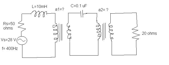

Determine the turns ratios a1 and 12 for maximum power transfer to the 20 ohm load resistor. a=n2/n1; Rs=RL for maximum power transfer, i.e. Zsource = the complex conjugate of the load.
i have try to use
Z1=a1^2*Zs and Z2=a2^2*Z1
and i know Z1=-j/(2*pi*f*c)
i have try to use
Welcome to the PF.
Wow, on the surface, that looks like a hard problem.
I'd offer a couple of hints, in hopes that they lead you to the answer. First, notice how the source and load are both real resistors (excluding the inductor and cap). So the inductor and cap have to cancel each other out in terms of complex Z, or else you can't match to the 20 Ohm load. What can you do with the first turns ratio to cancel them out?
And second, assuming that you can cancel out the complex impedances with the first turns ratio, what do you now have to do with the 2nd turns ratio to match the source and load impedances?
Show us your work along those lines, to see if it can work that way...
