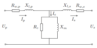

No, you cannot do this, using only resistors. A model of a transformer also includes inductance, and you don't know the values:
Thanks for the reply,
So the Unloaded current cannot be calculated this way. If we have no circuit on the secondary side, we are only considering the Primary Side Resistance from the windings (0.35 ohms). I am sorry if i am missing the obvious.
Thanks again!
In the model, Ip = Is + Ie. But you don't know Ie as you don't know the value of Xm. Thus, not knowing Ip, you don't know the primary copper losses.

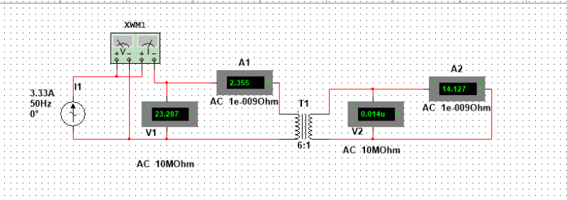

Hi Nascent, Thanks for the reply.
So i have my primary Closed Circuit Current which is the 3.33A i had calculated earlier since i was able to calculate the secondary current. Is that correct?
Via the simulation, to get the calculated values i had, the current source was placed in at 4.71 which gave me the values of the current i needed.
The No Load is Current is 5% less than the full load current. From what Hersch was explaining earlier i need to have an Ie and Xm but from the data i have given above this is all i have.
Thanks
There are 75w of iron losses. These don't change [much] from no load to full load. Have you used this to calculate Re to account for these iron losses?
How did you come up with a primary current of 4.71A for your simulation?

Don't forget, in the equivalent circuit model when there is no load there is no current in the secondary and therefore there is no current in the primary because at the heart of the equivalent circuit is an ideal transformer. So once you erase the ideal transformer from the circuit because it's taking zero current, all that's left is the path for magnetizing losses, here denoted r c.

No need to guess! Refer to the equivalent circuit. https://www.physicsforums.com/threads/transformers-under-load-and-no-load.811768/#post-5095883
Does it show iron loss current passing through the primary resistance? It does, though it is a simplified model.
