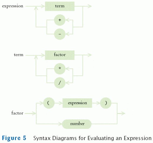

I am creating a class that will transform a basic arithmetic expression from infix to postfix (Reverse Polish Notation (RPN)). Then after then, it will evaluate the postfix expression and give the answer.
I have having a little trouble with the operators (+,-,/,0*, and %). Like, I have to create a method called hasHigherPrecedence(char c1, char c2), which returns a boolean saying where c1 has a higher precedence than c2. But I don't really know hwo to create this method. Can someone help me.

Umm, I think this is the precedence order from highest to lowest: * / + -. Where does the % go?

Create a syntax diagram and make code to follow it.
http://www.horstmann.com/bigj2/slides/slides18.zip
here is the cleanest program to evaluate an arithmetic expression I have ever seen. Evaluator.java, it took me some time to figure it out exactly but it is worft it.

I also had to write the same program in C (parse infix arithmetic expression and print postfix and prefix), I first wrote it in Java took me less than 30 mins, and then I tried to write it in C it took me about 7 hours to do it, I spend 3,5 hours searching for a bug it turned out that I allocated a struct wrongly, I could never have done such a mistake in Java, anyway, I am very pleased with my C program and specially with Java, one way is to do some elaborate substring work but that is a mess, there is an alternative way, you can do it recursively. Make a syntax diagram and follow it recursively, very hard to make a mistake then. Something like that
Code:
      Evaluates the expression.
      @return the value of the expression.
   public Node getExpressionValue()
      Node value = getTermValue();
      boolean done = false;
      while (!done)
         String next = tokenizer.peekToken();
         if ("+".equals(next) || "-".equals(next))
            tokenizer.nextToken(); // Discard "+" or "-"
            Node value2 = getTermValue();
            if ("+".equals(next)) value = new Node("+", value, value2);
            else value = new Node("-", value, value2);
         else done = true;
      return value;
      Evaluates the next term found in the expression.
      @return the value of the term
   public Node getTermValue()
      Node value = getFactorValue();
      while (!done)
         if ("*".equals(next) || "/".equals(next))
            Node value2 = getFactorValue();
            if ("*".equals(next)) value = new Node("*", value, value2);
            else value = new Node("/", value, value2);
         else done = true;
      return value;
      Evaluates the next factor found in the expression.
      @return the value of the factor
   public Node getFactorValue()
      Node value;
      if ("(".equals(next))
         tokenizer.nextToken(); // Discard "("
         value = getExpressionValue();
         tokenizer.nextToken(); // Discard ")"
      else
         value = new Node(tokenizer.nextToken());
      return value;
