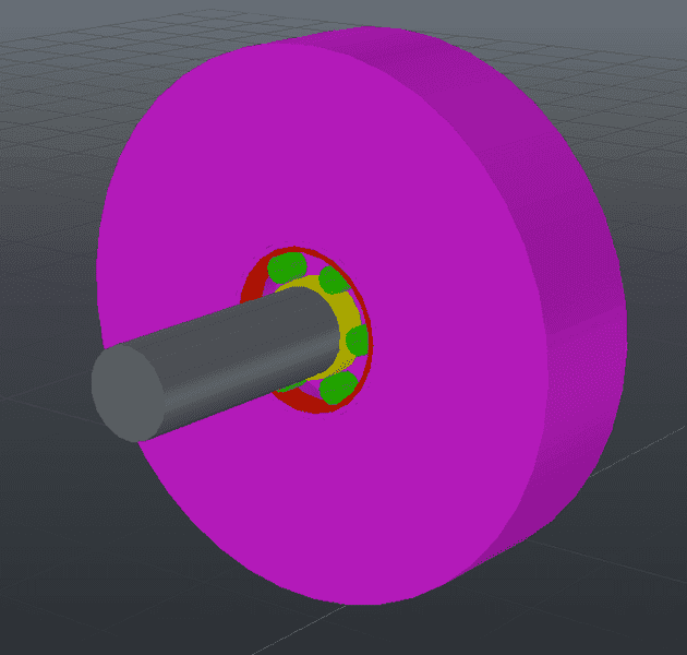

That seems to be a very complicated arrangement . Post a sketch of the crankshaft , flywheel and bearings and we'll see if something simpler is possible .
This is a quick representation of what I'm thinking of, which may be unrealistic. The grey is the crank shaft, the magenta is the fly wheel, red is the ring gear, green is planet gears, yellow is sun gear. These aren't the arrangement or number of bearings etc, but shows the general idea.
I want the grey crankshaft to rotate CCW while causing the magenta fly wheel to go CW.
Note the planet gears will be fixed in some manner also.

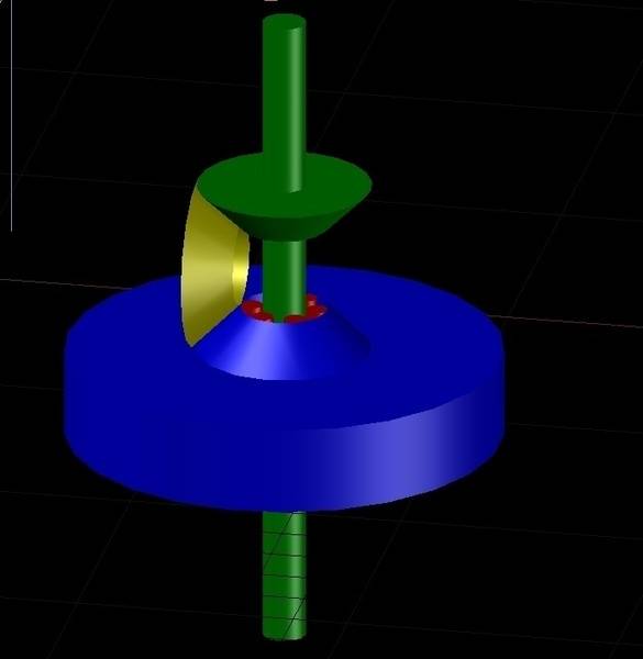

Here's what I drew up to clarify how I imagine it... green is your input shaft, the yellow gear (spider gear) is held from rotating around the input shaft's axis , but can rotate around it's own axis, which powers the side gea on the flywheel (blue).. Red is the rollers for the flywheel
You can pair and add more spider gears if needed, I didn't want to clutter the drawing with additional ones.
Likes Sirsh
