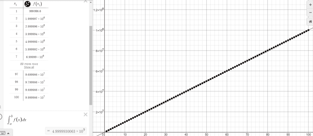

Hey everyone, I have generated a nice little velocity vs time graph that I would love if somebody could help me put to use.
I have marked data points on the x-axis for the Y-value for every second on the function.
Just to be clear: X-axis = time in seconds & Y-axis = velocity in meters/second. We have a constant acceleration.
I have also made an integral of the function, calculating the total area under the curve to be exactly 4.999993*10^9
However, since the 100 data points on the table would be quite tedious to manually apply the time dilation to √1-v^2/c^2 for every seconds at the different velocities. I have wondered whether there is a way to insert the values in my table directly into a calculus such that I retrieve the accumulated amount of time dilation over the 100 second journey depicted on the graph. I think there should be a way integrate these values with the Time dilation factor, even if we have to assume that we travel in constant motion, that increase every second.

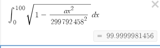

t : at : ##\sqrt{1-\frac{a^2t^2}{c^2}}##
The y-t graph y= ##\sqrt{1-\frac{a^2t^2}{c^2}}## would be what you want. Area under the graph
[tex]\int_0^T \sqrt{1-\frac{a^2t^2}{c^2}} dt < T [/tex]
is the time reading of the moving clock when time T in the Earth frame of reference.

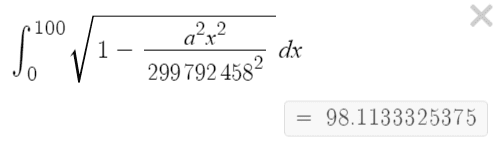

Wow, seems like it worked perfectly. Thanks! I'm getting two different values, depending on whether I square a & x separately. Not sure which one of these is correct and why - however it would be easy to estimate which approach is correct. That's awesome, been spending a bunch of hours on this and you were the saving grace.
Take a look at dimension of the form
[tex]\sqrt{1-X^2}[/tex]
1 is dimensionless. As well X = Z/c should be dimensionless.
