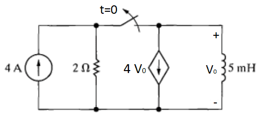

Hi all,
I tried to solve this, but I can't find the R(equal). I use the following method.
The circuit:
For t<0 the switch is closed so the iL(0-)=4 A
For t>0 it opens and the iL(∞)=0 A
Now, I want to find the value τ=L/R(equal)
Then I will use the: iL(t) = iL(∞) + ( iL(0-) - iL(∞) )* ( e^(-(t/τ) ) )
And finally VL(t) = L * [ ∂iL(t) / ∂t ] which is the Vo
What do you suggest ?Thanks.
Been a long time since I've used a simulator but I'm assuming the device in parallel with the inductor is a Voltage Controlled Current Source (VCCS) with 4Vo being its transfer function.
If that is the case, what resistance value would yield a current of 4 times the applied voltage?

There seems to be contradiction, I am confused.
On the one hand, the inductor current should maintain 4A at the moment the switch is turned off.
However, on the other hand, if the voltage of the inductor is initially zero, the VCCS should force the inductor current to zero immediately after the switch is turned off.
Where is my inference wrong?
