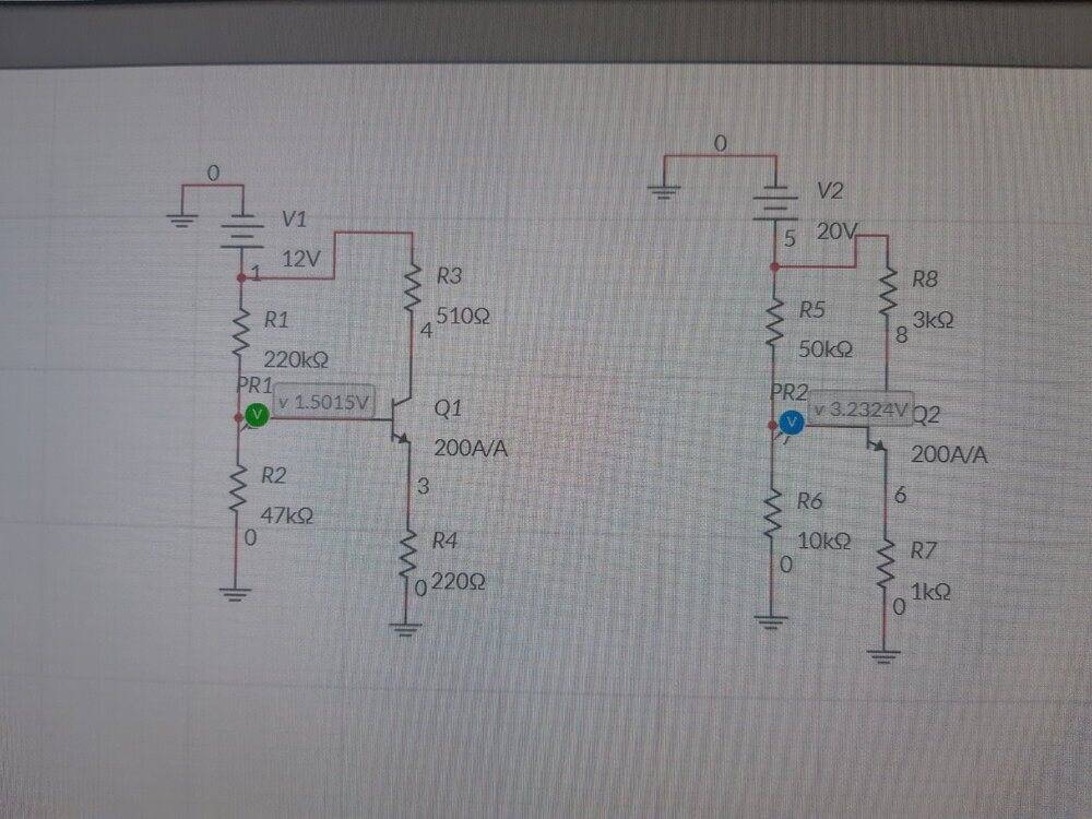

I am using voltage divider to find base voltage of transistor. I am getting two different results in two different circuits.
Hello,
I am trying to find base voltage. In attached picture (using Multisim) there are two separate circuits. Here is how I am doing the voltage divider:
Circuit on right:
Vb = (Vcc - .7)*R6/(R6 + R5) = 3.2V which matches Multisim result. No problem here.
Circuit on left:
Vb = (Vcc - .7)*R1/(R1 + R2) = 1.99V. Multisim giving result = 1.5V. My question is why ?
I checked with another simulator, and got same results as Multisim.
Am I doing something wrong ?
Thanks for any help.

Emitter voltgaes:
The circuit on Right: Ve = 2.45V
The circuit on Left: Ve = .7V

Baluncore said:
Solve the circuits by successive approximation. Each trial will bring it closer to the correct values.

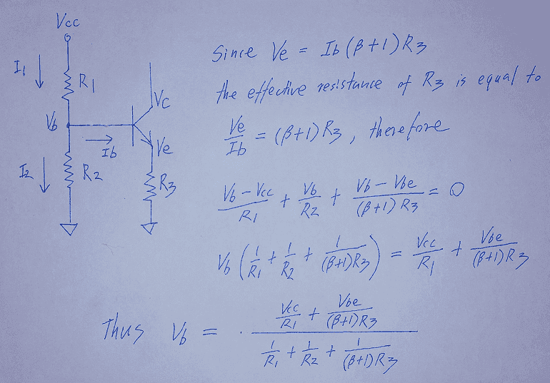

We can reduce the task simply to a system of two equations for two unknown quantities:
* Base voltage Vb=Vcc-I1R1=Vcc-R1(I2+Ib)=Vcc-[(Vb/R2)+Ib]R1
Emitter voltage Ve=IeR4=Ib(B+1)R4=(Vb-0.7V).
Now we have two equations for the unknown values Vb and Ib (with estimated values for B and Vbe)
Comment: As an alternative we could apply the superposition theorem. At first, we find the voltage at the base Vb1 caused by the supply voltage Vcc only (set Vbe=0) and - as a second step - we calculate the portion Vb2 caused by a voltage source of Vbe=0.7 volts (set Vcc=0).
Then we have Vb=Vb1+Vb2.
I hope to provide a more intuitive, concise and easy-to-understand derivation method for your reference.
Likes DaveE and Baluncore

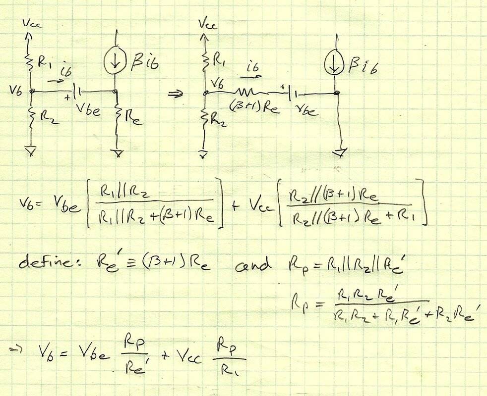

This would be a great case for substituting the "T" model for BJTs (the simplest DC model), as shown below. Then you follow what @alan123hk did above. It's also a good place to use superposition. The base voltage will be the sum of the 2 cases: Vb with Vbe=0, and Vb with Vcc=0, which allows you to use the simple voltage divider rule (twice).
