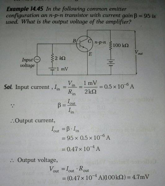

This is a solved example given in my Physics textbook . I am not understanding a couple of things .
1) How is Iin calculated as Vin/Rin ?
Why is the book not taking potential difference between Base Emitter into consideration ?
Instead shouldn't Kirchoff's Voltage rule be applied in the Base Emitter loop ?
I think it should be Iin =( 1mV -VBE )/2KΩ
2) Shouldn't the diagram be showing Vout across 100kΩ ?
I don't understand why book considers Vout to be VCE ?
Please help me understand these issues ?

##V_{BE}## is equal to input voltage which probably is small, much smaller than 1mV, so ##1mV-V_{BE}\approx1mV##.
I don't think this is the case .
I think in a silicon PN junction potential difference between Base and Emitter is about 0.7 V .
This is quite large as compared to the bias battery .
You might be right , I am not an EE and don't know much about transistors, just said to share my thought on this.

To me, it looks like a problem that is poorly presented. e.g., to forward bias ## V_{BE} ## , you normally need ## V_{BE}=.7 ## volts. They also don't specify the collector bias voltage. Perhaps someone else has a solution, but my recommendation is to not spend much time on this one as is. This "common emitter" electronic configuration is a good one to know, but this problem looks to me to be a poor one to use to try to learn it.

I looked at the problem in the "link" you had posted. For that one, with the book's example, a ## V_{BE} ## of 18.5 Volts I think is totally inaccurate. I expect if you hooked it up in the lab, you might find that ## I_B ## would be larger than what is computed using the value ## \beta=200 ##, and you would find ## V_{BE}=.7 ## volts. And then I think you might have removed the "link": https://www.physicsforums.com/threads/find-the-state-of-transistor.935500/#post-5909999 ## \\ ## Edit: And on this one. a base voltage of 1 volt might work, but they still need to specify the collector voltage. Also ## V_{in} ## (ac) usually gets coupled in with a capacitor, and ## V_{out} ## (ac) is usually also coupled with a capacitor.

I don't think this problem is practical and as Charles says, not much helpful in learning CE configuration.
The battery needs to be in series with the input ac source (theoretically). In this circuit, as per circuit theory, the battery can't dc-bias the transistor as the ac source is directly connected across the BE junction. Even if the battery were a 10V one, it couldn't dc-bias the transistor in this diagram.

See also my post 8. IMO, this textbook looks like it may contain numerous errors. I encountered that type of thing from time to time in my college days. The best solution would be for the OP @Jahnavi to learn the material from a book that presents it better and with fewer mistakes, if that is at all possible.

I have seen many junior college physics books in India showing wrong biasing circuit for CE amplifier. @Jahnavi, I believe that includes the NCERT textbook as well.
I agree that you should study amplifiers from some standard electronis books (or COP by H C Verma).

The way they show it, if you use ## V=1 ## volt, it would work, provided the ## V_{in} ## was ac coupled (with a capacitor).

Yes, but I wasn't including a coulping capacitor in my reasoning. If there isn't one, the battery is ineffective.

That Iin wouldn't be the true Iin as it won't flow through the base. It only flows through the battery. The base current will be determined by the input ac voltage, which will be the same even if you remove the battery.

The net BE voltage will be the input ac voltage. The battery is redundant as far as dc biasing is concerned.
Edit: assuming no coupling capacitor.

Ok, but when you connect the ac source, Iin≠IB.
Usually coupling capacitors are used on the ac signals, so that the bias voltage would not be short-circuited by the ac input connection. Meanwhile, oftentimes the ac signal can be a very small signal, sometimes from sensitive sensors where the signal needs to be amplified. A ## V_{DC}=1 ## volt could destroy some sensors. The ac coupling with a capacitor is quite necessary in these amplifiers.

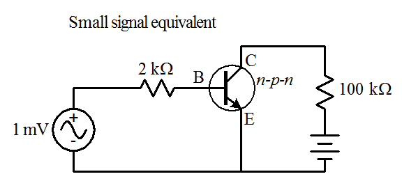

I suspect that the given circuit diagram is flawed; Perhaps the original intention was to represent the bias network's essential small-signal equivalent circuit, but something went wrong after the illustrator got hold of it. The 1mV apparently should be associated with the input source, not a base bias battery. Or, that battery originally was meant to be the small signal source, and the "Input voltage" source is a mistaken evolution of what should have been just a text label to a labelled source.
Note that the way that input source is connected the base bias circuit as shown would have no effect: the base-emitter voltage would be entirely determined by that source. It would need capacitive coupling to isolate it from the bias network and superimpose the signal on the bias.
That said, the given solution clearly assumes that the 2 kΩ resistor is in series with a 1 mV input signal and the base of the transistor, since they use it to calculate the base current, ##I_{in}## . So I'd consider take the circuit to be a small signal simplification that should probably have looked more like this:

The input voltage is often a weak ac voltage or current source, e.g. a photodiode or a microphonic element for an audio (sound) system. If you attach it directly to the point ## V_{BE} ##, it could simply get fried, if it is a low resistance element. ## V=1.0 ## volts is often far too much for that sort of thing. ## \\ ## The purpose of amplifier circuits such as this is to amplify the (small) signals, so that the signal is large enough to easily work with, and use. Sometimes additional amplification is then employed, e.g. to drive speakers in a sound system.
Jahnavi said:
Even if that is the case , wouldn't applying KVL give IB=( 1mV -VBE )/2KΩ ?
If the circuit is meant to represent an ac small signal equivalent, then the VBE would be zero (it's part of the DC bias circuit).
Jahnavi said:
If no coupling capacitor is used just as in the original example , how does AC input signal short circuit the DC battery ?
It doesn't short the battery, it shorts the branch containing the battery and its series 2 kΩ resistor. Applying an ideal source between two nodes fixes the potential difference between those nodes. In the given example the "input source" establishes the potential difference between the emitter and the base, rendering any bias circuit irrelevant.

Yes, and the battery is redundant.
