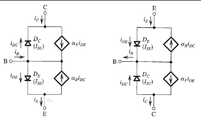

Gilbert said many times that base current should be zero, but how can a forward biased diode have zero current. Ideally Vbe should be zero since a forward diode ideally has no voltage drop.
Current control model was published in the Ebers-Moll 1954 paper. Emitter current controls collector current per
Ic = alpha*Ie.
Shockley equation relates p-n junction current & voltage, Id = Is*(exp(Vd/Vt)+1)
Combining gives Ic = Ies*(exp(Vbe/Vt)+1).
Ie & Vbe are related via Schockley. But Ic = alpha*Ie, is the equation for transistor action.
As electrons cross the base into collector, while holes cross from base to emitter, depletion zones are firmed resulting in barrier potential. This barrier is nearly equal to Vbe, & is determined by the current. A lab test affirms that Ie changes ahead of Vbe.

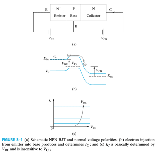

Hi Claude...You will remember some of our earlier discussions on this matter.
I agree that - as you wrote - emitter current controls collector current per Ic = alpha*Ie.
No doubt about this.
And therefore (as you have stated): Ic = Ies*(exp(Vbe/Vt)+1).
Final conclusion: Vbe determines (controls) Ic.
The base current Ib plays no major role - as far as the voltage gain of amplifier stages is concerned. The existence of Ib just reduces the input resistance of BJT based circuits.
(As THIS was the original question).
Do you agree?
(By the way: According to my knowledge, Barrie Gilbert has "never said many times that base current should be zero"). His position was that Ib does not "control" (determine) Ic in a cause-effect-sense. And therefore, this current would be more or less parasitic.)

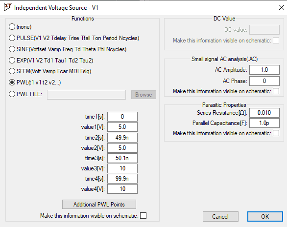

Anyway, the ebers-moll model published in 1954 shows bjt as Ic = alpha*Ie, not
beta*Ib. The i-v diode files are a simulation. Signal generator voltage is stepped into resistor & diode. The diode current is a quick staircase waveform. The diode voltage is slower, the current hits full value as the voltage hardly budged. Diode voltage is slow but settles to final value Ling after current settled. Next jump repeats the process.
Shockley: 2 forms of equation
1) Id = Is*(exp(Vd/Vt)-1)
2) Vd = Vt*ln((Id/Is)+1)
Many blindly assume that the voltage determines or "controls" the current. But the simulation shows that voltage on a p-n junction changes as a result of a current change. The current goes from existing value to the new value quickly. Voltage slowly catches up.
Diode current is NOT "controlled" by diode voltage.
Is it voltage or current controlled? Isn't that like asking is the heat in a resistor caused by it's voltage or current? You have both; you always have both. If you have a model that you like and that works, use that one.

Thank you for the long and very detailed answer.
However, with all respect - I did not want to learn something about Sue ...I only wanted to clarify which electronic force causes the charges to move.
To my opinion, it is an E-field within a conducting material. Perhaps I am wrong and it is the "vocal energy of Sue" ? A hard discussion...

You definitely seem curious about the topic but I think you have quite a lot of misunderstandings. I can highly recommend Chenming Hu's (TSMC Distinguished Professor Emeritus and 2020 IEEE Medal of Honor winner) Semiconductor Textbook, which should also qualify as a physics textbook. It was written with the practitioner in mind so it might be more up your alley than the more conventional physics textbooks.
I think there are many sections of it you would find interesting but I'll point out this particular section of chapter 8 as it seems to be on topic.
https://www.chu.berkeley.edu/modern...-integrated-circuits-chenming-calvin-hu-2010/
"Figure 8–1b shows that when the base–emitter junction is forward biased, electrons are injected into the more lightly doped base. They diffuse across the base to the reverse-biased base–collector junction (edge of the depletion layer) and get swept into the collector. This produces a collector current, IC. IC is independent of VCB as long as VCB is a reverse bias (or a small forward bias, as explained in Section 8.6). Rather, IC is determined by the rate of electron injection from the emitter into the base, i.e., determined by VBE. You may recall from the PN diode theory that the rate of injection is proportional to e^(qVBE ⁄ kT) . These facts are obvious in Fig. 8–1c."

  • #33
Ic is NOT "determined" by Vbe. Ic changes as a result of Ie changing. Vbe catches up eventually.
Many references, including uni texts, often use the Shockley equation
Ic = alpha*Ies*exp((Vbe/Vt)-1) as "proof" that currents Ie or Ic are "controlled" or determined by Vbe. But Shockley's equation is just as easily expressed as follows:
Vbe = Vt*ln((Ie/Ies)+1).
You & some text authors insist that changes in Ie/Ic are a *result* of changes in Vbe. A lab bench & scope test are needed.
I submitted a simulation showing diode voltage as changing after diode current has changed. LvW insisted that this Sim is only as accurate as the model used. Maybe lab set up is nevessary.
You’re wielding Shockley’s equation like it’s an axiom but it’s not. It’s a solution to a very particular system known as a BJT. But, where did Shockley derive it from? And what experimental evidence supports those equations? And what do they have to say about this topic? I would write it down but Dr. Hu has done an excellent job for me and I doubt I can improve upon his work. In addition Berkeley has made his work available for free! I suggest you take advantage of it.
Edit: I also just remembered Sedra & Smith has a pretty decent derivation of the Shockley equation (and MOSFET and PN junction for that matter) just using dimensional analysis which might be more approachable. It's definitely not free but it's been a standard microelectronics text for decades so I think most libraries, pretty much anywhere in the world, should be able to obtain it. The problem is that derivation will only work for a 1d transistor, basically one line in the cross section. But it illustrates the point nicely and succinctly.

  • #38
This attached pdf demonstrated the relation between Ie, Ib, Ic, & Vbe. The Vbe lags behind Ib, Ie, as well as Ic. Vbe cannot be the controlling quantity.
Not according to the plot you posted. The corners of the various traces perfectly line up at the same instant. The slopes do vary from drift time, parasistics, etc.
This can easily be seen at the 12ns mark where ALL the signals begin their transition at the same instant. Magnify the plot to about 1600% or more and align the Vbe corner with the edge of the window, now scroll vertically. You will see the other trace corners also align at the edge of the window.
Try scaling either the plot traces or the supplies/component values so that all traces have the same amplitude, that should highlight any delays that exist.

https://ecee.colorado.edu/~bart/book/book/chapter5/ch5_3.htm#fig5_3_1
  • #42
Cheers,
Tom
Thanks for examining my plots. Of course the trace align at the edge of window, we agree on that. But notice that Vne rises, eventually settling. But the currents, Ib/Ie/Ic rise faster, overshoot very slightly, then decrease, settling to final value.
Ic responds to Ie rising by rising, Ie overshoot its final value, so does Ic, as it must. If emitter emits more electrons, then collector will collect more electrons,, inevitably always..
Ie, & Ic, both settle to final values, as will Vbe, but Ic overshoot then decreases while Vbe is monotpnically rising. If Ic was controlled by Vbe, then Ic would monotlnically rise then settle to its final value, which it does not. A short time span exists where Ic is decreasing while Vbe still increased. Tjis is because electron collection in collecror is controlled by electron emission from emitter.
The emitter emission of electrons increased, overshot, then decreased & settled. The collector collection if electrons increased, overshot, then decreased & settled. Just like emitter emission did.
But Vne monolithically rose. After overshoot by Ie & Ic, Vbe was increasing while Ie was decreasing. Ic followed Ie, not Vbe. Ic was decreasing while Ie was decreasing & Vbe still increasing.
Ic responds to changes in Ie, while Vbe is responding to changes in Ib as well, but with extra delay.
I realize these are subtle points. It takes much examination to reveal these responses.
