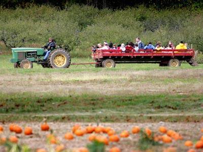

http://auto.howstuffworks.com/auto-parts/towing/equipment/tow-bars/drawbar-pull1.htm
note drawbar connection is low on tractor . That helps keep front wheels down when pulling, and helps keep trailer from toppling tractor over sideways on a downhill turn.
