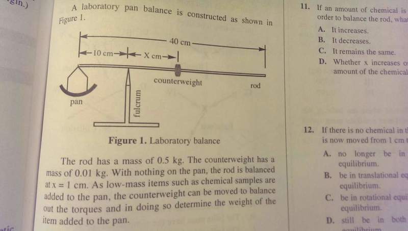

Hi Everyone,
I'm having some trouble with a problem concerning translational and rotational equilibrium. The question involves a balance with various masses suspended from it (see attached image). The question states that the counterweight is moved from 1cm away from the fulcrum to 2cm away from the fulcrum and asks whether or not the rod is still under rotational and translational equilibrium. I understand that it is no longer in rotational equilibrium because there is now a net torque acting on the rod, however the translational equilibrium portion is unclear to me. The answer argues that the masses suspended from the rod no longer exert the same force on the rod because they are now accelerating, thus translational equilibrium is no longer present. I am unclear as to why they are accelerating. I realize that the apparatus will rotate which gives it angular acceleration, but is this enough to conclude that it has linear acceleration as well (alpha =a/r)? If this is the case, how could we ever have have translational equilibrium while not having rotational equilibrium?
I'd appreciate any help, thanks.

Re: translational motion. What criterion is used to judge whether a rigid body is undergoing translational motion? What does this criterion say about the motion of the particular rigid body in this case?
Does the center of mass of the system accelerate?

The center of mass of the system would be the center of the rod which does accelerate. Does this mean that we can only have translational equilibrium while not having rotational equilibrium when the fulcrum is at the center of mass of the system? Also, the question asks specifically whether the rod is under translational and rotational equilibrium, thus I should only be concerned with the center of mass of the rod and not the system, correct? I realize they are pretty much the same in this case, but I just want to ensure that I understand the concept.
Thanks

In response to the question, the requirement is that the vector sum of all of the forces acting on the system should be equal to 0. From dauto's response I guess I should be focusing on the center of mass of the system, which does have a net force applied to it. My question from here is whether translational equilibrium can be present if rotational equilibrium is not present and the fulcrum is not at the center of mass of the system.
Thanks
You would do well to consider the motion of the center of mass of the rod as seen from some "stationary" (or inertial) frame of reference. Perhaps for simplicity assume that the fulcrum stand is at rest in this frame of reference along with the center of mass of the rod at its initial position.
The result of unbalanced forces working on a system results in motion. Sketch the motion of the center of mass of the rod for the case where it sits at the fulcrum and when it is offset from the fulcrum. If the center of mass moves in the chosen frame of reference then clearly there is translational motion involved.
