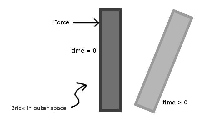

Imagine a long brick in outer space. You apply a force tangential to the center of mass. The brick accelerates in a transitional and angular fashion. There are no constraints or fixed axis. How would I calculate the translational and angular acceleration? I would like to run some simulations with Mathematica. I understand rotational problems with fixed axis and translation problems if the force vector passes through the center of mass. This problem is different. One force will cause rotation and the center of mass to move. I would appreciate any kind of help. Maybe I just don't know the correct google search terms to figure this out.

Hi Julian and welcome to PF.
It is important to specify if the force is applied for a short duration, like a sharp kick, or if it acts continuously. If the latter is the case, then you need to specify its direction as the brick moves. Your drawing suggests that it's a sharp kick (impulse). Is it?

Thank you for pointing that out. For now, let's say it is an impulse or high force for a short interval. If the force is closer to the center of the brick, the brick will move more but rotate less. If the force is far from the center of mass, the brick will rotate a lot and not move much. Correct? Am I making this too complicated? Can I somehow break this into two problems (rotation and movement)? That doesn't seem right. Do I need to know about Euler's equations of motion? I really appreciate the help.

Correct.
Yes you can. There is translational motion of the center of mass (CM) and rotational motion about the center of mass. In other words, the CM will move with velocity VCM and at the same time the brick will rotate about the CM with angular speed ω. An observer moving along the brick with speed VCM will see the brick just spin.

You do not. You need to conserve linear and angular momentum before and after the impulse is delivered to the brick. Hint: Call the impulse delivered to the brick ##J## and proceed from there. The linear momentum before the kick is ##P_{before}=J## and the angular momentum before the kick is ##L_{before}=r~J## where ##r## is the distance from the CM to the point on the brick where it is kicked. You should be able to derive expressions for ##V_{CM}## and ##\omega## in terms of ##J## and the brick's dimensions and mass.

Yes, you can avoid rotation completely, by applying the force through the CM.

No, the linear velocity will be the same as in the previous case, if you apply the same high force for the same short time interval.

Not necessarily correct. Much depends on the details of the impulse that is applied.
If one is applying a fixed force for a fixed time (i.e. a fixed amount of momentum) then the delivered linear impulse and the resulting linear momentum is the same regardless of where the force is applied. The delivered rotational torque [about an axis located at the center of mass] will then be directly proportional to the offset of the force from the center of mass.
This may seem counter-intuitive at first. How can the same impulse applies at different places deliver result in obviously different energies? Does that not violate energy conservation? It does not. If one applies the same force for a fixed time and if the object is able to rotate under that impulse then the result is a different distance moved by the point of application under the applied force. The delivered work is greater when the force is delivered near the end of the block than when it is delivered near the center.
If one applies a fixed force over a fixed distance (i.e. a fixed amount of work) then all is exactly as you say. If delivered closer to the center, the brick will move more but rotate less. If delivered closer to the end, the brick will rotate a lot and not move much.
