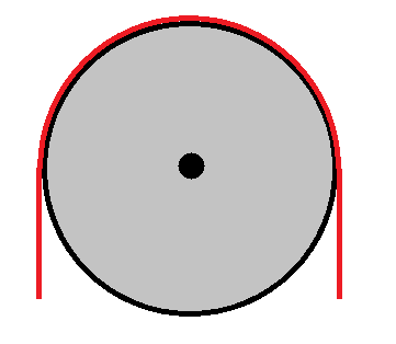

@annamal Consider this example, a homogenous string (red color) with mass m is placed on the pulley (cylinder) with mass M, so that the system is in rest, see figure below.
What is the magnitude and direction which the pivot is exerting on the cylinder?
Isn't it just (M+m)g straight up?
So with weights on either end of the red string, it would be (M+m + Weights)g?
There is no difference between increasing the weight of the string than hanging on some weights.
Because the pulley (cylinder) is in equilibrium, the net force on it must equate (vectorially) to zero.
Consider this too. A box with mass M is placed on the floor. On top of the box, a stick (red) with mass m is placed. What is the force on the box from the floor? Isn't it just (M + m)g upwards?
Now place some weights on the stick, what is the force on the box from the floor now?
