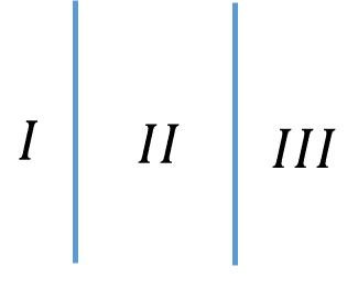

To calculate Transmission and Reflection amplitudes (t and r), say in the figure below which is composed of three regions, first we have the solution of Schrodinger equation in each region as: [tex] \psi _i=A_i |i> +B_i |-i> ; i=I,II,III[/tex]. It seems that by matching the three wave functions and their derivatives, the coefficients A and B can be obtained. However, there are only four equations obtained at the two borders while there are six unknown coefficients! In addition, as far as I know, all the texts consider [tex] B_{III} =0 [/tex] to calculate t and r ! Could anyone please help me?
The incoming wave has to come from either the left or the right, and we have to choose which direction, as an initial condition. If the wave enters from the left, then AI is nonzero and BIII is zero. If the wave enters from the right, then AI is zero and BIII is nonzero.
Regardless of the direction of the incoming wave, its amplitude is arbitrary. We treat it as an arbitrary constant, then divide it into other coefficients in order to find r and t.

hokhani said:
But I don't know what you mean by incoming waves.
In ##\psi=Ae^{ikx} + Be^{-ikx}## the positive exponential corresponds to waves/particles/whatever traveling to the right (+x direction), and the negative exponential, to the left.
To get the time-dependent wave function, your solution for ##\psi## gets multiplied at the end by an overall factor of ##e^{-iEt/\hbar}## which gives you traveling waves in one direction or the other depending on the sign of the x-exponential.

This is the main point of the argument: to obtain the energy eigenstates according to what was said earlier, we first suppose an incoming particle (moving particle) from left to right and so put [tex]B_{III}=0[\tex]. However you said "a moving particle is not an energy eigenstate". So how one can calcualate the energy eigenstates?
You calculate the energy eigenstates from the time-independent equation. That doesn't give you the wave function of the particle, it gives you the eigenfunctions that can be selectively combined according to the initial conditions (in this case, particle is known to be moving from left to right) to give you the time-dependent wave function of the particle.
However, in this problem you don't need to do all that work. The plane wave is (the time evolution of) an energy eigenstate, and as jtbell explained, you can use that to calculate the transmission and reflection coefficients. You can do this even though the plane wave doesn't localize the particle at all.

Let me explain what I understand of this argument and please correct me if I am wrong;
We can not distinguish the direction of movement considering only time-independent Schrodinger equation but by considering the time-dependent behavior, we know the direction the particle is coming from ( for example left to right) and hence to solve the time-independent Schrodinger Equation we set (in my example) [tex]
B_{III} =0.
[/tex]
Then we obtain the eigenstates of time-independent Schrodinger Equation, and by linearly combining them we can obtain the traveling wave packet.
