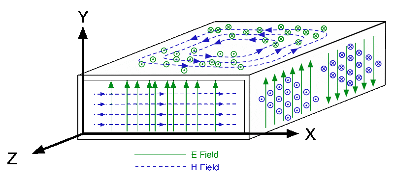

Do you mean the Field distribution over the end? Do we have a translation problem here?
So, the field distribution would be a cross section of the waveguide, right? What I meant with the "output profile" was more like the Power Profile. So the question is: can I have a power profile of a single mode waveguide that is for example rectangular shaped?
your term power profile still doesn't really make sense

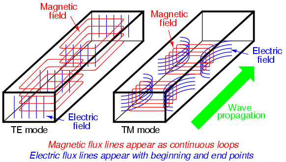

do you understand how the electric and magnetic fields look inside a waveguide ?
maybe you should have labelled your thread as B for basic
have you seen these diagrams before ? ...
Thank you for your reply, daevnn. Sorry, I might have labelled it wrong. It is probably a basics problem. Yes, I have seen these before. I think I understand how the waves propagate. What I tried to say is: when I "cut" the waveguide (like a cross section), I will get a sinusoidal function for the E-field for example. Because this is how the waves propagate, just like in the pictures you send. But if I simulate a device, I can also plot the input-output profile of this device, which is like the spectral response, right?
