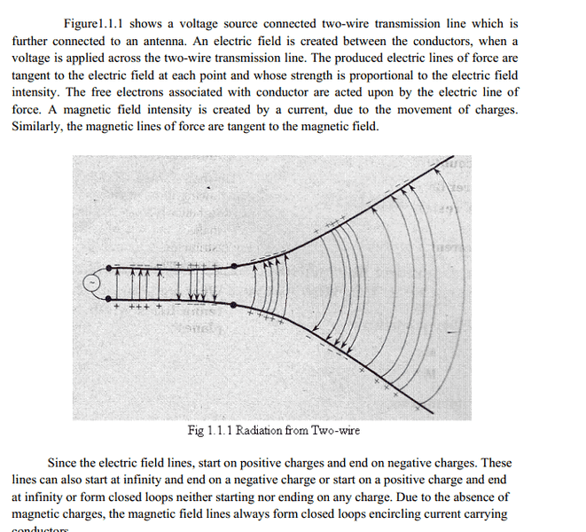

This question is about transmission line that I use between my Ham radio and the antenna.
We a transmission line that is made of two parallel conductors close together. The current in one conductor is exactly the same as the current in the other conductor, but flowing in opposite direction. Transmission line's impedance is 50 ohm and it is terminated into a 50 ohm load. In every text it says that their fields will cancel each other and there will be no radiation looking at some distance "d" that is much larger that two conductors separation.
That sounds logical but we still have two wave sources from those two wires. Even if their fields cancel each other at the distance they must still lose power due to the radiation.
So why doesn't the transmission line radiate all the power away?

There is radiation from each wire, but it almost cancels at some distance away because the wires are close together in terms of the wavelength. It can also be thought of as mutual impedance between the lines which reduces radiation. The line can be considered as two antennas mounted close to each other and driven in anti phase.
By the way, I would be surprised if you have a two wire line with a characteristic impedance of 50 ohms - it is more likely to be a few hundred.
If standing waves exist on the line, this means that the current will be exaggerated at some parts of the line and will increase the radiation, but as we have seen, it is still negligible. It is usually satisfactory to use an open wire line at very high VSWR, even 20 or 30 is still satisfactory, and allows the matching adjustment to be made at the transmitter end of the line, which is very convenient.

One way of looking at it is that the two wires constitute a very thin loop antenna. Such an antenna is very badly matched free space so it will not radiate much power.
But a simple two wire feeder does produce finite radiation. The effect of this radiation can cause crosstalk between nearby open wire feeders (and audio lines) which can be partially canceled by reversing the connections every so often - and by twisting the pairs.

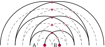

GhostLoveScore said:
You are not talking about destructive interference?
a%2Fscience%2Fgrade-11%2F06-2d-and-3d-wavefronts%2Fpspictures%2F6acd38d48065ef988dddb89df4f1dd9c.png
That way we would have areas with no radiation and areas with radiation. That's obviously not how transmission lines work.
That diagram is not appropriate here. A and B are a small fraction of a wavelength so the interference pattern will have a very shallow max and min. The absolute level will also be small because of the mismatch.

I think the diagram which is, I think, by J D Kraus, is very misleading. It is not enough to just create a 377 ohm transmission line to obtain radiation. Sorry I cannot recommend a book which describes the process of radiation in a correct and simple manner.

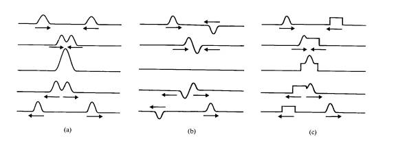

I have started studying physics in 2010, but I took a break in 2013. Hopefully I will continue this or next year. But yes, I would want to take courses in electromagnetics.
I know I can't understand it completely without looking into a math and equations, and I know that lot of weird stuff happens in near field of the antenna.
Can I at least look at it this way. There are two waves that are 180 degrees out of phase in the transmission line. Their fields cancel each other like this (b case)
Not literally like in "b" case, just that part where their amplitudes cancel each other.
