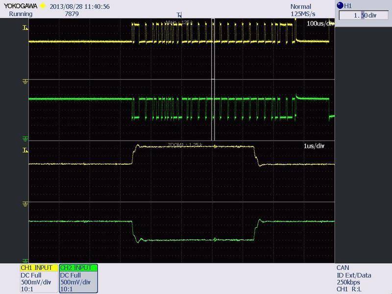

I am simulating an unshielded twisted wire pair of a communication network, Controller Area Network.
Bus Speeds taken into consideration are 250/500/1000/2000 kbps.
Depending on the physical dimensions of the wire and insulation dielectric constant, I have computed the R,L,C,G parameters. Since, the wire length will be smaller than 300meters (i.e. considering a 1Mhz freq.), I am using lumped parameters for each section of the wire for simulation purposes.
The general topology of the circuit is a 3 Node network, with line terminations of 120Ω at the two ends of the bus. For simulation purposes, one node of the network will be transmitting, and the others will be receiving. The lumped model is defined by the generic, RLCG model.
There are a few things, where I cannot get my head around, need your help on it:
1. The orientation of the model? Generally, the model has R, L at the node where the current is entering the circuit. Is this a rule?

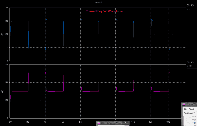

2. If I model the circuit to have a more distributed parameter, for e.g. instead of having a R,L,C,G model of one section of length 1m, I could split it up in 10 models of 0.1m for every section. Doing this resulted in a very distorted waveform, when the node is not transmitting(at 2.5V, everytime, everywhere). When I just use one model, that is lumped, the waveform is even, and almost follows the measured values. Why?
3. As I move farther away from the transmitting node, the initial spikes(transient) keep on increasing. This is not the case, in measured voltage waveforms. Why does this happen?
I have attached files: Capture being the simulated circuit, 3 Node at Sender being waveforms for transmitting end, and 3 Node at Farthest end being, well that is self explanatory. '004' is the measured waveform in the lab.

As for the glitches you are seeing, I think I understand. It looks like an imbalance in the propagation paths (delay) and crosstalk between the lines. The purple path is earlier than the green path.
The transceivers works this way: During the recessive stage both the pins are at 2.5V. In the dominant stage, one is pulled at 3.5V while the other is 1.5V.
As you mention the glitches are caused due to the crosstalk and propagation delay, I thought about it and googled too, but I can't seem to find any explanation(can you please elaborate a little on this phenomenon?) to it or what could be done to avoid it.
The cable has been designed to have a delay of 5ns/m with a char. impedance of 120Ω. It is terminated at both ends at with resistors of 120Ω.
From what I understand, the current in the inductance is causing the spikes at those points. Is it common for that to happen even in the real world, or is it just a limitation of the lumped models or a limitation in design?
