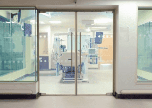

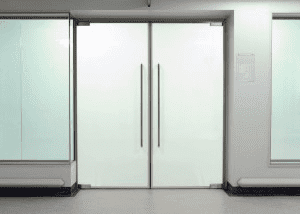

You can also get glass which becomes opaque when you pass a current through it.
https://www.smartglassinternational.com/electric-switchable-glass/
Erm. Does this means that these will switch transparent in case of a power outage?
Just asking :doh:
Smart glass does not have “a current pass through it” as that would be very inefficient. Switchable glass has a liquid crystal film, between transparent conductive layers, within the laminate that change optical characteristics when subjected to an electric field.
The glass becomes transparent only when a voltage is applied.
