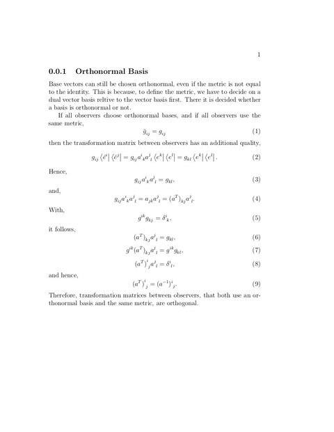

In my opinion, the clean way of doing this is to take the transpose of metric type matrices only. So of a matrix with either to upper or two lower indices.
For the coefficients of tensors, there is no rule of where the upper or the lower indices have to go, with one exception. If you want to use the convention of how to multiply matrices and vectors, so the row times column rule. There is no need to follow this convention, as you can always write down the full tensor equations with all their indices. But if you want to follow the convention, then you will have to stick to some rules to be consistent.
The basic rule for this convention is, that upper indices run along columns and lower indices along rows. That immediately poses a problem with a metric, with two lower indices. A metric doesn't have an upper index that runs along columns. Hence a metric can't really be written as a matrix.
When it comes to the orthogonality equation of the Lorentz transformation, people often fix this by swapping the indices of the Lorentz matrix horizontally and denote this by the transpose. I think the consistent way of doing this is to raise the first index of the metric instead. That is twisting the notation as well, but less so than swapping indices horizontally. With one upper index, the metric and the whole equation can be written in matrix form. Then one can swap the index of the Lorentz transformation between upper left and lower right corner to get the transpose.
So again, I think the confusion with this equations is due to the fact that for this kind of tensors, namely vectors, dual vectors and (1,1) tensors representing linear transformations, one would like to use the matrix vector multiplication convention.
