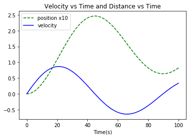

Is the code correct ? or Does it looks like a good code in terms of implementation of the trapezoidal rule ?
It appears to correctly implement the trapezoidal rule to Integrate velocities to estimate position.
I ran the code, and the graph appears correct, but it is difficult to tell what the velocity is doing because of the different scales.
I created another list, called d10, which stores the distance values, divided by 10. These values are just for plotting. Then change the legend.
I'm not sure if it should say position x10 or /10. I think on a tachometer on my car the numbers are 1.0 2.0 etc
and I think it says RPM x1000. Anyway, here is what that graph looks like. With the position scaled down, it is easier to visualize what the velocity is doing.
Also, something you could do is run the formula for the trapezoidal rule in Excel. It only took me a few
minutes to copy your data into a spreadsheet and then create cells to calculate the position.
Then take the numerical output of your python code to see if it matches.
Likes Arman777
So the max position is 2.5, which represents 25 (meters?)
Probably a better legend for position would be to say (dekameters, or x10 meters), that is if the velocity is meters/sec.
Likes Arman777
Also you need to take care to note the difference between distance traveled and distance from start (which what I called position)
Think of this as a 25 meter swimming pool, and the swimmer starts from the block, swims down toward the end (positive velocity), then swims back toward the start (negative velocity). Your graph doesn't come back to zero, but when the swimmer makes it all the way back to the start, she would be at position zero again, yet the distance traveled would be 50 meters. What your program calculated was position, rather than distance traveled.
I just came across this post. I am now noticing it is 2.5 months old. Better late than never, I guess.
Likes Arman777
Thanks for your reply. I ll try to look at it again. Its possible that I have made some mistakes..
I don't know if this function is supposed to return to zero in this context, that was just an example that I came up with of the swimmer returning to the starting point. If you do want to capture "Distance Traveled" then you'd need a different formula. One way would be to integrate in sections. Have a section when the velocity is positive, then have another section when the velocity is negative, then take the absolute value of any "negative distances" and add them together.
The graph of velocity appears to be the shape of a sine wave. You could be able to fit a curve to your data and arrive at an analytical solution for the integral. This would give you an idea of the error associated with estimation.
Likes Arman777
Yes that was on my mind
distance = [0] #the initial value
for k in range(N):
d = abs(1/2 * h * (function[a + k*h] + function[a + (k+1) * h]))
distance.append(distance[-1] + d)
It should be like this.
Thansks for the tips.
