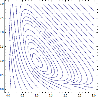

But the fixed point is in the positive half-plane actually now you can see this pictures I'll post it here and you'll see that there is a limit cycle in the positive half-plane, more specific, in the first quadrant so... I need to build a trapping region in order to... at least in averge the divergence points inward taking out the fixed http://file:///C:/Users/PankeP%C3%BCnke/Desktop/limit11.png point...

Your definition is totally correct, the missedpoint is that the trapping region must contain the fixed point, especifcically for this system we got $$(b,1/b)$$ as a fixed point, which in other words is the intersection between de isoclines.
Now we can se a kind of a "triangle" that take inside both isoclines and the fixed point mentioned before. Now we got to demonstrate that de divergence in that region is negative for all pointo except for the fixed point. You'll see in the image that there is a limit cycle.
Trouble is you have with your talk of trapping region not told what you are looking for and asking that I can understand. It looks as if it might be "the condition (b value) for existence of a limit cycle".
Ax limit cycle is a trapping region. If you are looking for a limit cycle, or something about it, please say so. If instead you are looking for a trapping region that contains the limit cycle, or contains the s.p., there is an infinite number of them, so you have to add some condition to what is demanded like "the smallest right triangle that contains the limit cycle" or something.
