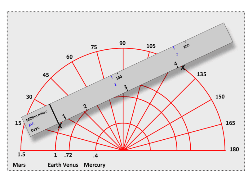

I have a suggestion that might be more useful of your time.
I am a big fan of analogue computation.
  1. Plot all relevant (circular) orbits on a map.
  2. Make a ruler whose units are days/weeks/months.
To use:
  1. Decide where two planets are in relation to each other on the map.
  2. Measure it with your ruler.
  3. Profit!
* ruler is roughed-in but accurate enough.
So: if you the GM decide that Earth and Mars are, say, (125-20=)105 degrees apart in their orbits, and your players navigated in a straight line, accelerating at 1g for half the trip then decel'ing at 1g, that should be a trip time of just over 4 days.
Note: the solar system is averse to being rendered in just one scale; you'll need a whole another calculator if they want to visit the outer planets.If you want to pursue this line of thought, I'd suggest this thread would be served better in the Sci-Fi Fantasy Forum, where our math isn't constrained by reality.

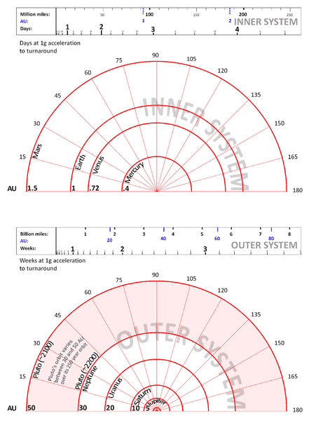

One question I don't have an answer to @ckirmser : what year(s) is your campaign set in? It makes a big difference in Pluto's travel time.
In AD 2100, it's about 50 AUs out, which is about 3 weeks trip time,
but if it's set nearer AD 2200, Pluto is only about 30AUs out, which is more like 2 weeks.
Here is the final calculator, barring tweaks.
Likes Drakkith

I had firgured that the destination planet would move enough to throw off a direct measurement, but, if not, I'll just go with that.
There's a SciFi forum? I had no idea - 'course, didn't look for one, though...
Thanx!

Don't like my calculator in post 13?
Oh, no, I liked it, but I already have that sort of tool built in with Astrosynthesis. I was hoping there'd be a formula where I could plug in the angular separation and the difference in orbits that would give me a distance.
