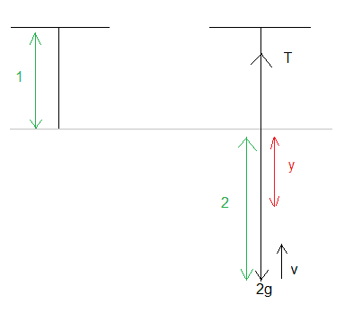

Hi,
Can anyone please help me with the following:
I have found the velocity of projection, no problem, it is v = 2*sqrt(10)
Also, in obtaining this value, I have also found the extension in the string when in equilibrium, it is x = 2
Now on to the time of flight.
The given answer is: t = ( PI/(2 * sqrt(40) ) + sqrt(2)/sqrt(10)
So the motion is in two parts, one when the string is stretched and so pulling on the mass, and one where the string is unstretched and so the mass is simply a projectile.
I am going to try to calculate the time taken to rise from 1m below A to A. This is the part of the motion which is that of a projectile. And I believe form the given answer that I zshould expect to obtain sqrt(2)/sqrt(10). I do not.
Hopefully, someone can show me where this method is in error:
Here's a diagram:
On the left is just the string, on the right is the string stretched by the 2g weight.
Let the general position of the particle be y below the unstretched level. The tension in the string is T. Hookes law gives T = Kx/a where K is the modulus of elasticity (here = 10), a is the natural length (here = 1), and the extention is x (in the diagram this is equal to y).
So we have T = 10y
Now equating forces gives (F = ma):
10y - 2g = 2 * acceleration
And so we have: acceleration = 5y - g = 5y - 10
Now, as accerleration = dv/dt = (ds/dt)(dv/ds)=v (dv/ds) we have:
v dv/dy = 5y - 10 and so separating variables gives:
integral(v dv) = integral(5y-10 dy) and so we have:
(1/2)v^2 = (5/2)y^2 - 10y + c
And using v = 2*sqrt(10) when y = 2 leads to c = 30
and so we have (1/2)v^2 = (5/2)y^2 - 10y + 30 which is
v^2 = 5y^2 - 20y + 60
So we can now put in y = 0 to obtain the speed of the mass at the moment that the string becomes slack. From here I use v = u - gt to obtain t - the time to go from slack to A. This leads to a different answer from the book.
Thanks for any help in pointing out my error,
Mitch.
v dv/dy = 5y - 10
Be careful with signs here. In setting up F = ma you chose the upward direction as positive. But y increases as you move downward.
You may write dv/dt = (dv/dy)(dy/dt), as this is just the chain rule. But does dy/dt = v or does dy/dt = -v?
Likes sysprog
Thank you very much, that was it, the writing of dy/dt as v was the mistake. I should have written it, as you say, as -v. Then I obtain the book answer of sqrt(2)/sqrt(10). Thanks so much for spotting this. I will be more careful in future.
My remaining task is to find the time taken to go from the initial point of projection to the point 1m below A. The form of the answer PI/(2 * sqrt(20)) makes me think that this part of the motion should be treated as Simple Harmonic Motion. Is this in fact the case? If the particle had simply been released then I can see that it would be, but is it still Simple Harmonic Motion if the particle is initially projected with some velocity?
(If I were to try to use my equation of "v as a function of y" to solve for "v as a function of t" I would get: dy/dt=sqrt(20y-5y^2+20) and this leads to (20y - 5^2+10)^(-1/2) dy = dt and integrating the LHS isn't pretty and given that the context of the question is a chapter on SHM I'm thinking that there must be a smarter way)
Thanks for any help.
Ok, I was not too far off, my mistake was thinking that the integral was unpleasant, in fact the integral is simply -(1/sqrt(5))*asin((2-x)/(2*sqrt(2))) and it all works out to the book answer.
